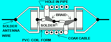

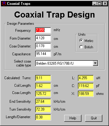

The Coax trap program computes design parameters for the construction of coaxial traps for HF usage. Typically these are constructed from PVC tube and RG58/59 coax.
Only 4 parameters need to be known: the design operating frequency, the coil form diameter, the coax diameter and the coax capacitance per foot. Coax characteristics are provided for various Belden cables.
