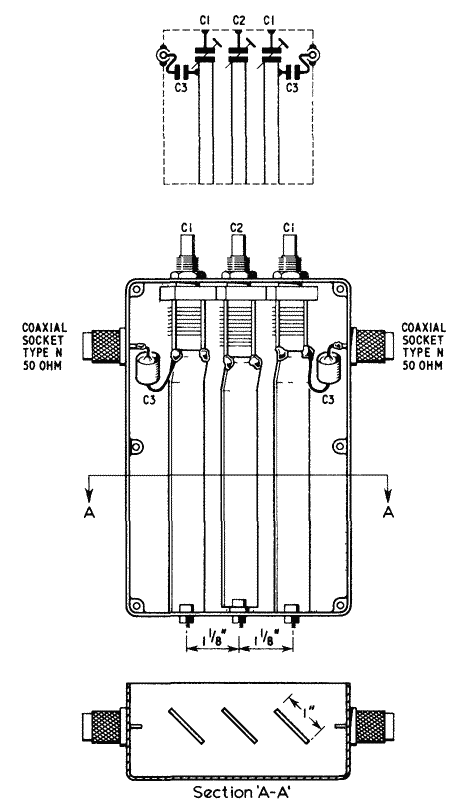

Fig 5.92. The circuit and layout for a 100W 145MHz slab-line filter. The strips are 1 x 1 /16 in (25 x 1.5mm) sheet copper, offset at 45° to avoid overcoupling. Input and output lines are 6 1/2 in (165mm) long;
the centre resonator is slightly shorter to allow for the greater length of C2 and a rib in the cast box. C1 = 50pF, C2 = 60pF, C3 = 4.4pF

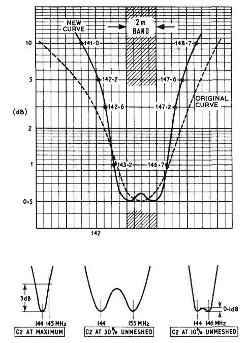

gives dimensions for band-pass filters for the 144MHz band [27]. The connections between the copper fingers and the die-cast box are at current maxima and must have the lowest possible RF resistance. In the prototype, the ends of the strips were brazed into the widened screwdriver slots in cheesehead brass bolts. The 'hot' ends of the strips are soldered directly to the stator posts of the tuning capacitors. After the input and output resonators are tuned for maximum power throughput at the desired frequency with the centre capacitor fully meshed, the latter is then adjusted to get the desired coupling and thereby pass-band shape (Fig 5.93).

Fig 5.93. Performance curves of the 145MHz slab-line filter as affected by the setting of C2. Note that the insertion loss is only 0.6dB. Also, compare the -10dB bandwidth of this filter with that of the filter of Fig 5.89:7.7MHz for this filter when tuned to 'new curve', 13MHz for the four-section filter with small, lower-Q coils
