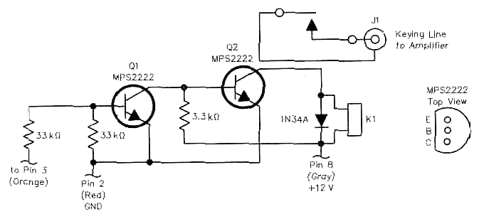

After buying a new IC-706 MK2, my enthusiasm was overflowing on the way home from the store. I was going to hook up my little (27 pounds) 450-W amplifier and have some fun. To my disappointment, there was no jack on the new rig to control an outboard amplifier. Consulting the manual did not help because I was not about to buy an IC-4KL with a remote control. However,

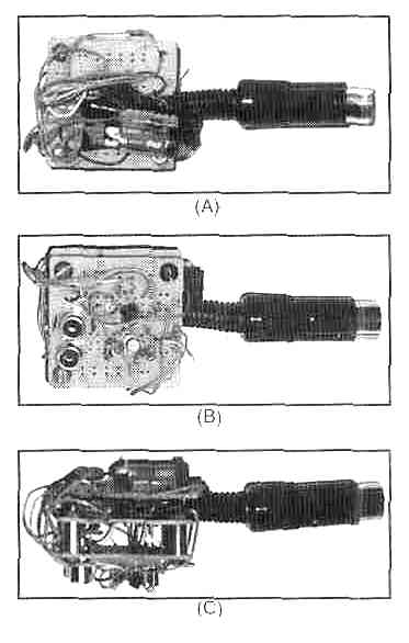

after studying the ACC socket connection, a solution came to light. At pin 3, the orange wire goes from +8 V when receiving to ground or negative when transmitting. Fig 3 is a two-transistor circuit to close a reed relay when transmitting. This circuit is the brainchild of W3NNL. In a few hours, I built it on a RadioShack #276-148 dual mini-circuit board. (Fritz snapped the board
in half to make two smaller boards.-Ed.) I used one half of the board to terminate the 13 wires from the ACC socket. The board is clamped to the cable jacket. The other half of the board contains the two-transistor circuit plus two phono jacks to make the relay and ALC connections. Pin 8 (gray wire) supplies +12 V for the circuit, pin 2 (red wire) is ground and pin 3 (orange wire) is the keying input from the ICOM. The reed relay is mounted on a very small piece of
project board (RadioShack #276-149) that is taped to the ACC cable. See Figure 4. The reed relay completely isolates the amplifier keying line from the transceiver. Since my amplifier does not have the luxury of full QSK, I use semi-QSK and a 0.2 second delay. It works great!
Figure 3-A schematic of W3NZ's circuit that lets the IC-706 Mk 2 transceiver control an external power amplifier. All resistors are 1/4 W, 5% units. Equivalent parts may be substituted for those shown. RS and RSU numbers are RadioShack catalog numbers. Q1, Q2-MPS2222 NPN transistor, K1-12-V reed relay.
Figure 4-Photos of W3NZ's IC-706 Mk2 external amplifier-keying circuit. (A) The ACC plug and termination board. The relay is taped to the cable jacket (B) The board containing the transistor circuit and two phono jacks. One keys the amplifier; the other is for ALC. (C) A side view of the
assembly containing both boards.

Устройство предназначено для подключения внешнего усилителя мощности к трансиверу IC-706MK2, поскольку в трансивере нет отдельного выхода для усилителя, а имеющийся слишком слаб для коммутации внешнего реле. Сигнал для коммутации и питание берутся из аксессуарного разъема АСС. Транзисторы любые средней мощности, например КТ601, КТ603 и т.д.
