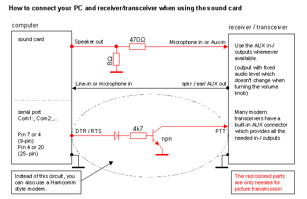

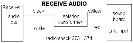

JVCOM Interface

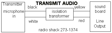

The above circuit is recommended for use in SSTV applications with use of the sound card with a computer. This is the JVComm style of interface. This circuit may also be used for RTTY and PSK31 applications. Many users modify the above circuit to include 1:1 isolation transformers within the Speaker out and Line-in or microphone in lines. These isolation transformers are used to preclude ground loops within a system from introducing hum and interference on the transmitted signals.

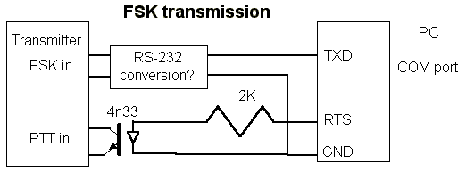

So you say "I want FSK capability as well as Push-To-Talk" (PTT). The following circuit is used with WinRtty to provide capability for FSK Rtty and a PTT circuit for the program. This circuit may be used in many applications and may be substituted for the circuit contained in the JVComm interface shown above.
What goes in the "RS-232 conversion" box depends on your transmitters FSK input. Odds are, it can be exactly the same as the circuit shown for the PTT connect: use an opto-isolator with a series resistor to convert the RS-232 levels to open/close keying. The portion of this circuit related to PTT may also be used instead of the PTT circuit in the JVComm interface described above.

The simplest and quickest computer to radio interface is to connect the Line
Output from the Sound Card to the transceiver audio input with a 100:1 voltage
divider to reduce the voltage output, and the Sound Card Line Input to the
audio output of the radio. You can use the VOX to switch from Receive to
Transmit.
To setup this arrangement, adjust the sound card output level
using the computer 'mixer' control until maximum transmit power is reached, and
the ALC is
just starting to read. Then tune to a strong carrier and
adjust the soundcard input gain until the red line goes away as observed on the
spectrum display.
(waterfall indicator) This procedure is covered in great
detail in the PSK31 Help files under "setting up the sound card".

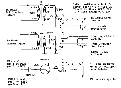

The circuit below shows the method WM2U used which isolates the Sound Card
Line In and Line Out from the Radio using a couple of Radio Shack transformers,
and a 2N2222
transistor to switch the PTT radio line triggered by the RTS
line of the computer Com Port. All audio levels are equalized when running
either the computer, the SSTV program
or PSK31. A switch is used to switch
between Computer and the Radio Modes. To adjust this circuit, tune to a strong
carrier and tweek RV1 until the red overload lines
disappear. At this point
simply tweek RV2 to give the required output power from the transmitter.
The
author of this information is WM2U.

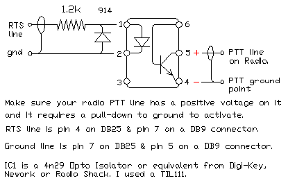

To completely isolate the computer from the radio the PTT line schematic shown above should be replaced by the following optically coupled circuit. WM2U has this unit installed and it works great.

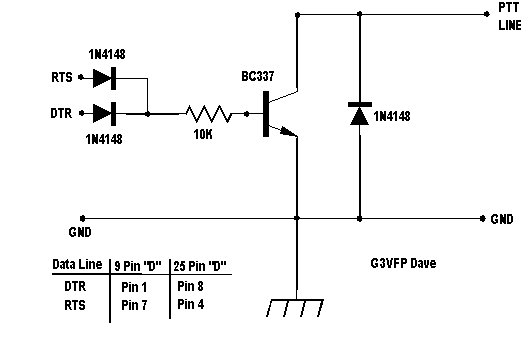

Another interesting PTT circuit from G3VFP to cover both the
RTS and/or DTR source.
You can use a 2N2222 in place of
the BC337 transistor in this circuit.
