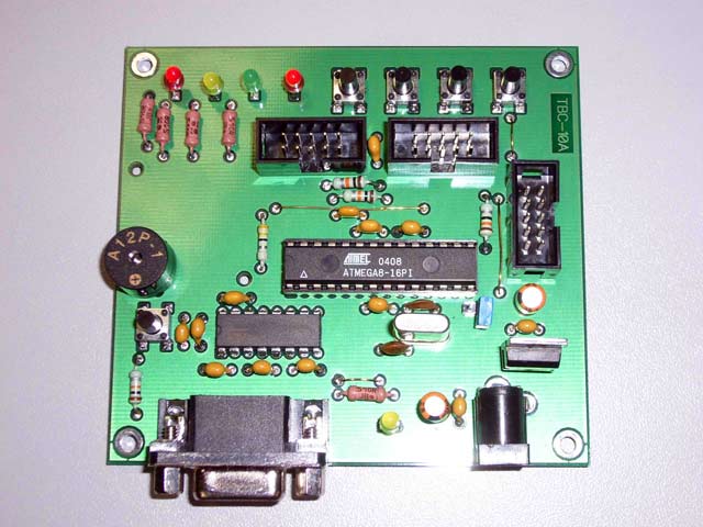

The view of controller PCB is shown below in the figure 1.
Figure 1

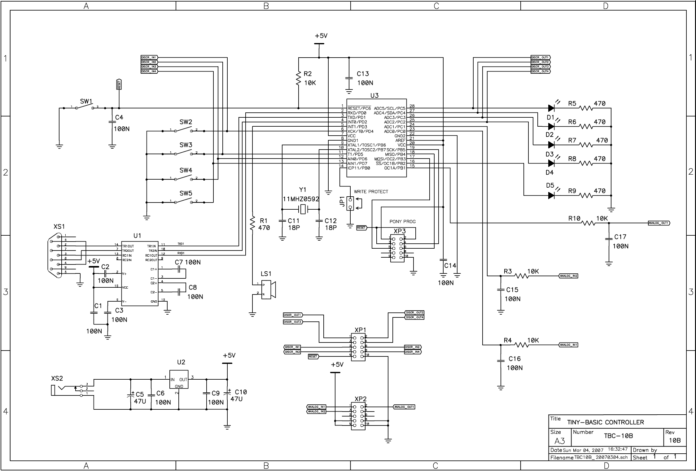

The controller schematic is shown in the Figure 2.
Figure 2

Short description of schematic:
U3 is AVR microcontroller ATMEGA8.
The control program with thr BASIC interpreter for this controller is programmed by ISP after
PCB is assembled.
The firmware can be downloaded from here.
We used PonyProg programmer
(http://www.lancos.com/prog.html)
connected through the connector XP3.

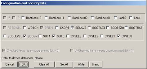

The Figure 3 shows how the fuses bits should be programmed.
Figure 3
U1 is TTL/CMOS <-> RS232 transceiver
U2 is 5V voltage regulator
LS1 is a buzzer. This one can be any system buzzer.
Make sure that the current drawn by pin U3:5 is be limited to 20 mA.
To prevent the user program from erasing there is the jumper JP1.
When it is closed re-flashing of the user program is disabled.
LEDs D1
D4 indicate state of discrete outputs.
LED D5 indicates the program state. When the program is run the D5 is turned on.
When D5 is turned off it can mean that program is stopped or waiting for
input (INPUT command) or a delay (DELAY command).
Push button switch SW1 controls the RESET line of microcontroller ATMEGA8.
Push button switches SW2
SW5 are used as test signals for debug purposes.

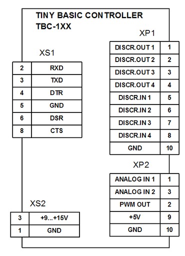

To connect external circuits there are connectors XP1 and XP2.

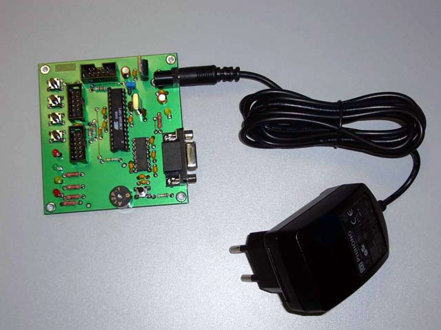

TBC as a Black Box is shown on the figure 4.
Figure 4

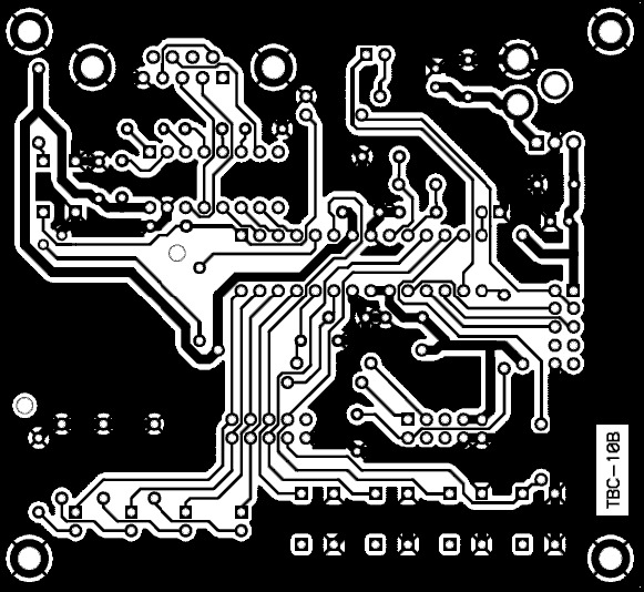

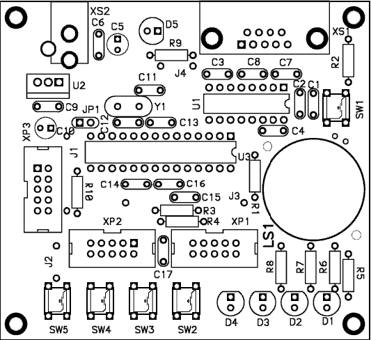

The PCB layout is show in the figure 5
Figure 5
The assembly diagram is shown below
Figure 6

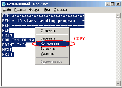

The method of working with the TBC and a console is shown below.
At first you should create program text in the notepad.
Then copy the whole text to the clipboard.
Figure 7
Press the reset button on the TBC. There is a one second interval to send the
SPACE symbol to theTBC to activate the downloading process.

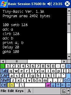

You can use a palm size PC as well. A PDA console is shown below:
Figure 10

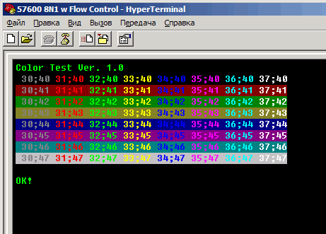

1.The "Color" test
PRINT "$";27;"[1;32;40m";"$";27;"[2J";"Color Test Ver. 1.0"
for j = 40 to 47
for k = 30 to 37
PRINT "$";27;"[1;";k;";";j;"m ";k;";";j;
next
print
next
PRINT "ΞΚ!"
The result of the program is shown below.

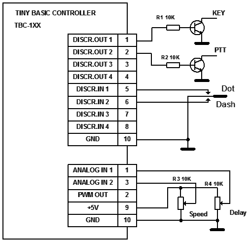

2.Semi-automatic Elbug Key
This Elbug Key has the function of a CW VOX. Input changes of speed
and hold delay is achieved by measuring the voltage on the variable
resistors as shown in the figure 12.
Figure 12

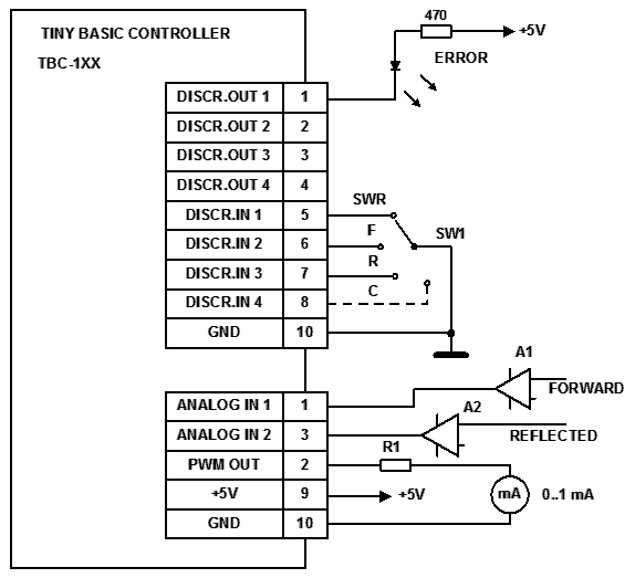

3. Automatic calculator for an SWR-meter
The schematic of the SWR meter (calculator part) is shown below
Figure 13
Short description
Analogue inputs receive normalised signals from the reflected wave and the forward
wave detectors. Levels of these signals are 5 volts at maximum power. Calculated
SWR is output on the anologue meter by PWM.
Position Ρ of the mode switch is the test position for calibration at the manufacturing stage.
For calibration do operation:
1. Start the terminal program
2. Power up the TBC. Input signals are not needed for this operation.
3. Input the value -1 by the console. PWM will be set to the value 1000
4. Adjust resistor R1 for full scale deflection
This resistor can be calculated by formula:
R1 = 0.976 * U/I Rπ,
where:
U controller VCC
I current of full scale deflection
Rp analogue meter internal resistance
5. Inputs value of SWR for scale calibration
Description of some variables
N number of samples for average;
K defines scale zooming
Last point of scale defined as
SWR = (10+K)/K
Zero point corresponds SWR=1
K=1, last point of scale 11
K=2, last point of scale 6
K=3, last point of scale 4.333
K=4, last point of scale 3.5
K=5, last point of scale 3
K=6, last point of scale 2.666

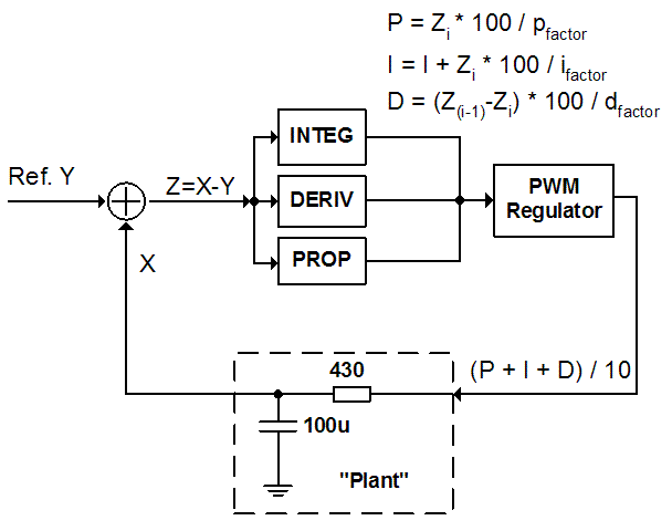

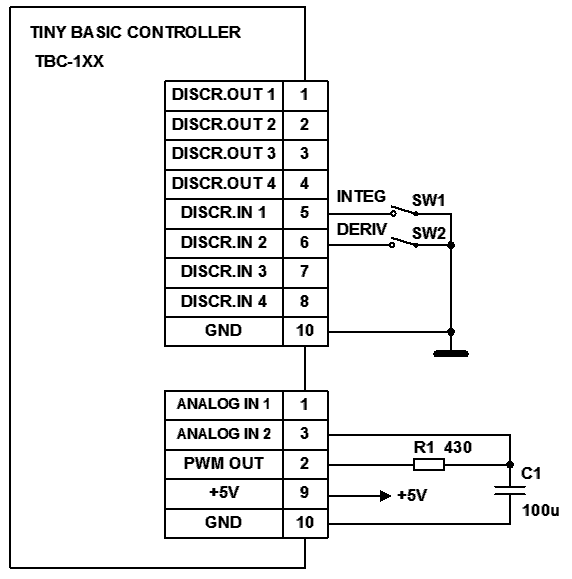

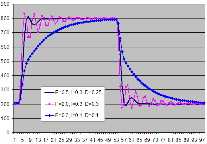

4. PID regulator
This is an outline program to learn PID regulators. The external connections to the
basic-controller and block diagram are shown in figures 14 and 15. The program has
an automatic switch of reference. It allows you to watch the signal on an oscilloscope.
You can turn logging on in terminal program to output to a file.
Finnaly you will get text that can be converted by EXCEL to a diagram like
the one shown in figure 16.
Figure 14
This schematic and program outline has an automatic switch of the reference.
Figure 15

Figure 16

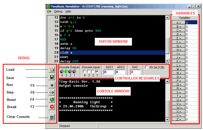

Simulator
Simulator is a program for Windows 98/NT/XP. It allows you to write and debug a program
without programming real controller. Simulator can simulate the controller resources
except the beeper. Simulator console does not recognise the ANSI ESC codes.
Simulator allows run program, stop, execute step-by-step, watch variables and resources.
To stop the program at specified places you need to insert STOP commands after required line.
The Simulator window is shown below:
Figure 17
All of the controller resources are shown on the screen.
The debug process is controlled by the four buttons:
F9 start program
F2 force program stop. After stopping the program can be continued by pressing button F9
F8 step-by-step execution
F4 simulator reset
Inside the edit window standard operation Ctrl+C, Ctrl+V,Ctrl+Z are allowed.
Simulator can be downloaded from here.
