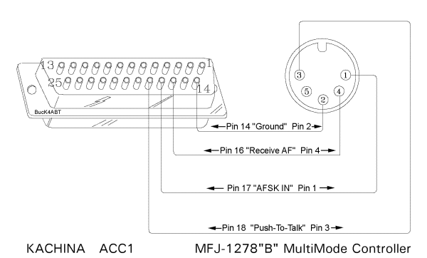

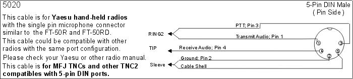

NOTICE: Read the following as it will prove helpful later.

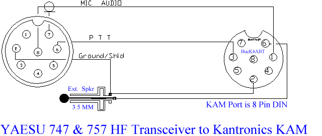

The mic and TNC connections pictured on these pages illustrate the connections you will encounter with most radio to TNC interfaces. Most manufacturers will apply the same pin connection scheme to their radios when using the same type mic (number of pins) connector. For instance, most all models of ALINCO transceivers which have 8 pin Mic connectors will use the same pin connections;
e.g. Pin 1 = AFSK IN, Pin 2 = PTT, Pin 8 = Ground for PTT, and Pin 7 = Shield. Receive audio is usually taken from the External speaker (in most transceivers, a 3.5 millimeter plug).
One very important reminder; For best TNC DCD performance, your transceiver volume should be
set between the 9 and 11 o'clock position. I've found that too little audio (below the 9:00 O'clock setting), is not good. Likewise, too much receive audio will create distortion and will cause inconsistent decoding of Packet data. Knowing this, we soon understand that an optimum setting for the volume control is at the
ten o'clock position. The Squelch may be set in a similar manner, usually aroung 10 or 11 o'clock position... unless you have local CPU noise, whereupon, you have to govern your settings
accordingly.

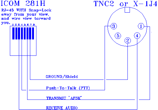

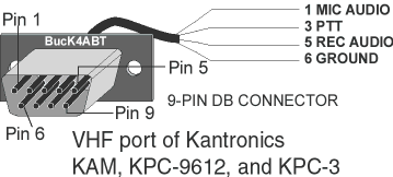

A simplified example of a PacketRadio TNC to transceiver interface.
Notice the above drawing; This is one of the most popular TNC (Radio port, Input/Output (I/O)) connectors in use today. This 5 pin DIN connector is almost a ''standard of the industry.'' Knowing the names of the signal and control wires for your TNC will save a lot of time when making your radio to TNC interface.
This drawing depicts the VHF radio port of the Kantronics KPC/KAM series.
''NOTE that no connections are made to pin 7!''

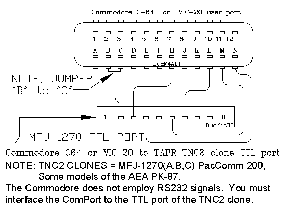

PC and compatibles, TRS CoCo's, and Commodore
Serial and TTL Comport interfacing

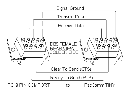

- PC DB9 male
serial comport to PacComm Tiny II and other DE9 TNC comports. connectors.

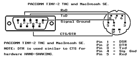

- Tiny 2 TNC to MacIntosh SE,

- MFJ, PacComm, and TNC2 Clones TTL port to Commodore 64 or VIC 20 Interface Cable

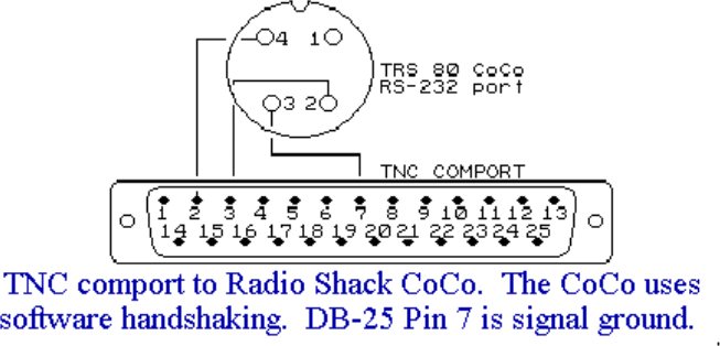

- Tandy / RadioShack
Color Computer Serial port to TNC Interface

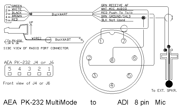

ADI transceivers to various TNC

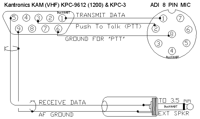

- ADI 8 Pin Mic to MFJ-1270C.
- ADI 8 Pin Mic to AEA PK-232 Multimode controller.
- ADI 8 pin Mic to DRSI PC*PacketAdapter.
- ADI 8 pin Mic to Kantronics KAM (VHF port), KPC-9612(1200 baud port), and KPC-3.

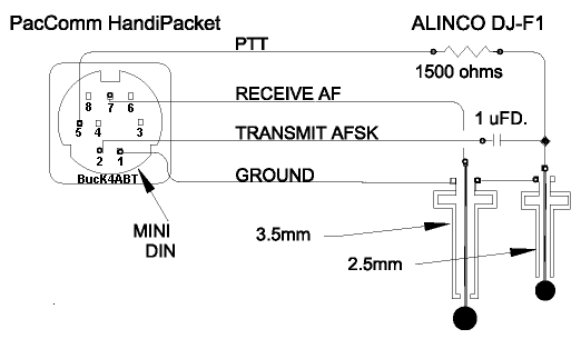

- ALINCO DJ F1 to PacComm "HandiPacket" TNC

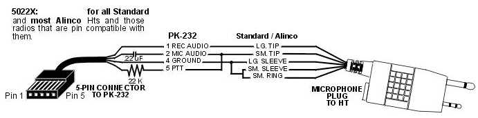

- CABLE for Alinco transceivers with modular (RJ-45, 8 pin) MIC port for 1200 baud interface to Kantronics; KAM (VHF), KPC-9612 (1200 baud port) or KPC-3 DE9 radio port.

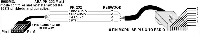

- CABLE No. 5086x; For
Alinco and Kenwood radios with 8 pin MIC connector. Receive audio is from 3.5mm Ext Spkr jack.
Interface; AEA PK-232.

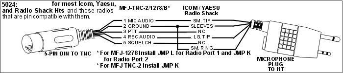

- CABLE No. 5022; For
Alinco and ''Standard'' hand-held radios with dual (2.5mm and 3.5mm) pin microphone/Ext Spkr connectors.
Interface; TNC2
and compatible 5 pin DIN, TNC connectors.
- CABLE No. 5022x; For
Interface; PK-232, 5 pin inline mini connector.

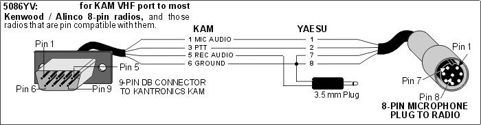

- CABLE No. 5028yv; For
ALINCO, and Standard hand-held radios interface requiring inline resistor and capacitor to enable PTT and MIC I/O. For the HT with two jacks (2.5mm and 3.5mm), microphone/Ext Spkr connectors.
Interface; KAM/KAM+ (VHF port), KPC-3, KPC-2400, and KPC-9612 1200 baud ports.

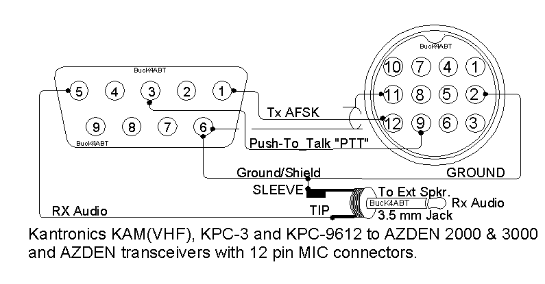

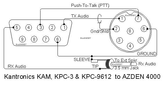

- Early AZDEN 2000, 3000 and AZDEN transceivers with 12 pin MIC I/O to Kantronics KAM, KPC-3, and KPC-9612 (VHF port).
- AZDEN 4000 w/8 PIN Mic to Kantronics KAM (VHF port), KPC-3, and KPC-9612 (1200 baud port).
AZDEN 2000 & 3000 transceivers with 12 pin MIC I/O to TNC-2 (MFJ, PcaComm, AEA) and TNCees with 5 pin DIN radio ports.

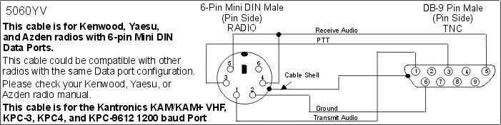

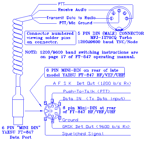

- CABLE No. 5060; For the
Azden, Kenwood, and Yaesu radios that have the 6 pin, Mini-DIN, 1200 and 9600 baud data port.
Interface; TNC2 and compatible 5 pin DIN, TNC connectors. *READ NOTES ON DRAWING.

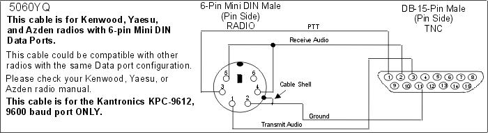

- CABLE No. 5060yq; For the
Interface; Kantronics KPC-9612 9600 baud port.
- CABLE No. 5060yv; For

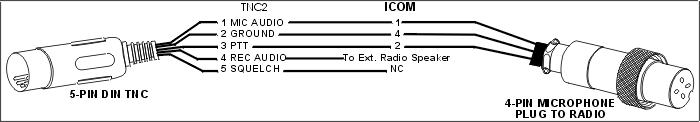

- ICOM Transceivers and Hand-Held to TNC2.

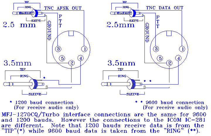

- ICOM IC-207 to MFJ-1270CQ Turbo (Both 1200 and 9600 baud port interface).

- ICOM IC-281 RJ45 MIC I/O to MFJ-1270C or X-1J4 TheNET node.
- ICOM IC-281 to MFJ-1270CQ Turbo 300/1200/9600 baud TNC (Icom 281 both ports, 1200 and 9600 baud).

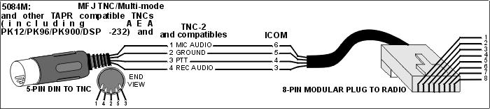

- ICOMs with 8 pin MIC connectors to TNC2 clones.

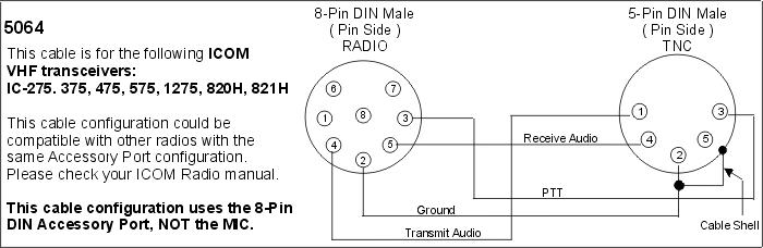

- ICOM VHF transceivers; IC-275, 375, 475, 575, 1275, 820H, and 821H. (*NOTE Receive audio is at pin 5).

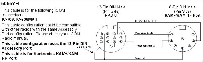

- ICOM Radios; IC-706, and IC-706MKII 13 pin Accessory port. (*See notes on drawing).
Interface; TNC2 and compatible (Including the MFJ-1278 and PK-900) 5 pin DIN, TNC connectors.
Interface; KAM/KAM+ HF port
Interface; KAM/KAM+ VHF port, KPC-3, KPC-2400, and KPC-9612 1200 baud port.

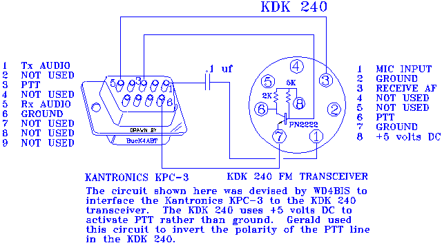

- Special PTT circuit for the KDK-240.

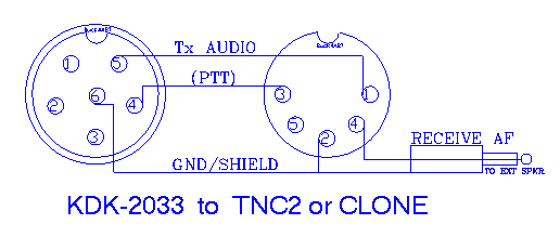

- AEA PK-2232 and PK-900 MultiMode Controllers to
KDK-2033
- PacComm, MFJ-1270,74,78, or the AEA PK-96 TNC to
KDK-2033
- Kantronics KPC-3/KPC3 Plus to KDK 4 pin MIC I/O.

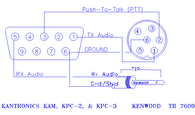

Kantronics KPC-3, KAM, and KPC-9612, 1200 baud ports to the 6 pin MIC I/O, Kenwood TR-7600 transceiver.

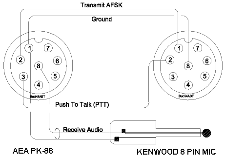

- The AEA PK-88 TNC interfaced to KENWOOD transceivers with conventional 8 pin MIC I/O.

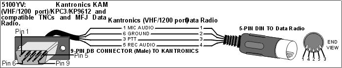

- CABLE No. 5100yv; For
MFJ-8621, 31, VHF DataRadio transceivers with 5 pin DIN Data I/O connector.
Interface; Kantronics KAM/KAM+ (VHF port), KPC-3, KPC-2400, and KPC-9612 1200 baud port.

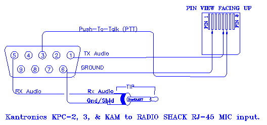

- Radio Shack RJ-45 to Kantronics KPCs & KAM

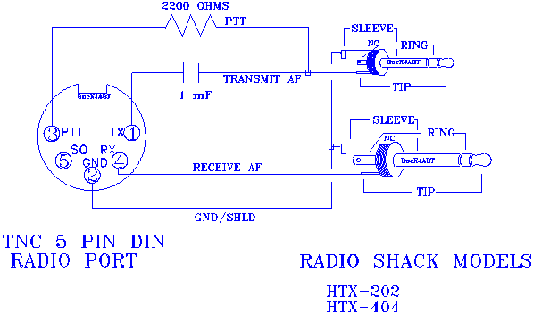

- Radio Shack hand-held transceivers to TNC2 Interface

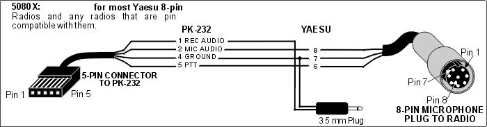

YAESU transceivers to various TNC

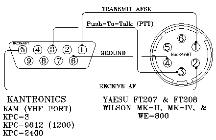

- YAESU FT-207, FT-208, and WILSON MK-II, MK-IV, WE-800 to KANTRONICS KPC/KAM

- Yaesu transceivers with 8 pin MIC connectors.
Interface; MFJ-1270, 1274, 1278, some PacComs, AEA PK-12, PK-96, PK-900, and DSP-232.

- Yaesu transceivers with 8 pin MIC connectors. Uses Ext Spkr Jack for receive audio.

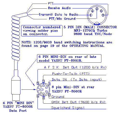

- YAESU FT-8000R Dual Band Mobile transceiver 1200 and 9600 baud interface to MFJ-1270CQ Turbo.

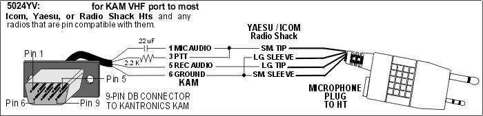

- Yaesu, Radio Shack, and ICOM hand-held radios with dual (2.5mm and 3.5mm) pin microphone/Ext Spkr connectors.

- Yaesu, Radio Shack, and ICOM hand-held radios interface requiring inline resistor and capacitor to enable PTT and MIC I/O. For the HT with two jacks (2.5mm and 3.5mm), microphone/Ext Spkr connectors.

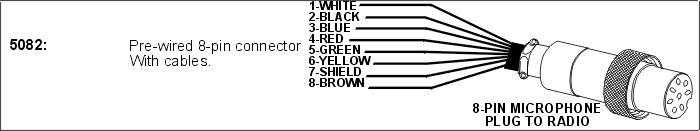

- CABLE No. 5082; Numbered/prewired 8 pin Standard MIC connector.
