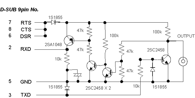

ICOM CI-V interface to RS232 using transistors
pro: No external power needed.
con: Requires standard compliant serial port, may not work on all notebooks.

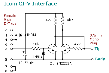

ICOM CI-V interface to RS232 using transistors, fits in DB9 case
pro: Very small, fits in DB9 connector case (with SMD components)

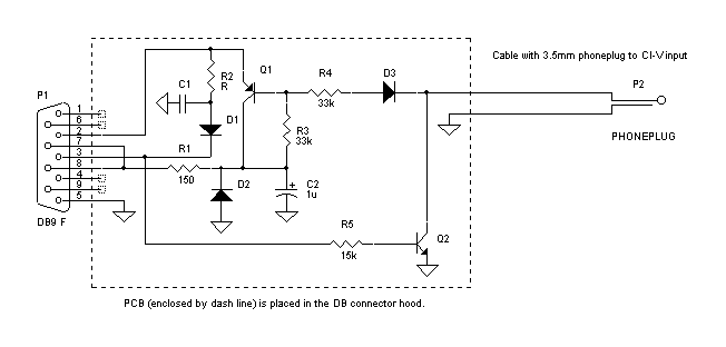

Alexander from Russia writes:
Concernig scematic for CI-V adapter. I drew down it from real pcb so I specified part value for readable components only. They all are smd.
C1 - ceramic (looks strange but it's true),
R5 - at least 0.5W
Q1 and Q2 I guess can be any switch transistors.
I checked this adapter with CI-V Explorer software, everything's ok.

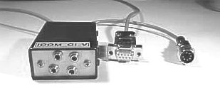

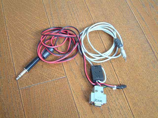

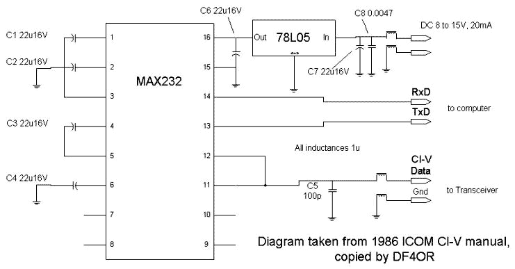

ICOM CI-V to RS232 interface using MAX232
This design is in use with all my ICOM rigs since many years, without any problems. The power comes directly from the ICOM rig, one of the AUX connectors on the rear.
Since this connector provides SQL (open, closed) information as well, i have fed this line through the MAX232 to the RS232 CTS signal and can use it in my software.
External view of homebrew interface with 4 connectors to rigs.
Internal view. Not pretty, but it works :-)

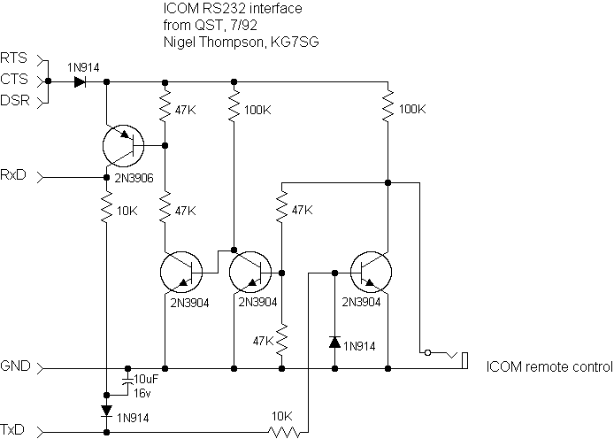

A design with opto isolation by Gary Dion.
He writes in May 2001:
I built one of the designs (the one by Nigel, KG7SG) and it worked great. However, being the paranoid type I decided to design my own electrically isolated version. I figure it would be preferred in a field day situation with questionable rig grounding.
The biggest challenge was powering the optos on the radio side. The 8v line coming from the 706 can source at most 10 mA (per spec). This design pulls an average of less than 0.5 mA. This voltage can be pulled from either the ACC connector or the michrophone jack. If the microphone jack is already being used, it is likely connected to an isolated audio interface. Many isolated audio interface degins already exist, so I decided not to include that on the schematic.
I love being able to find -and share- all this stuff on the web... -Gary if-gary.gif - 9818 Bytes

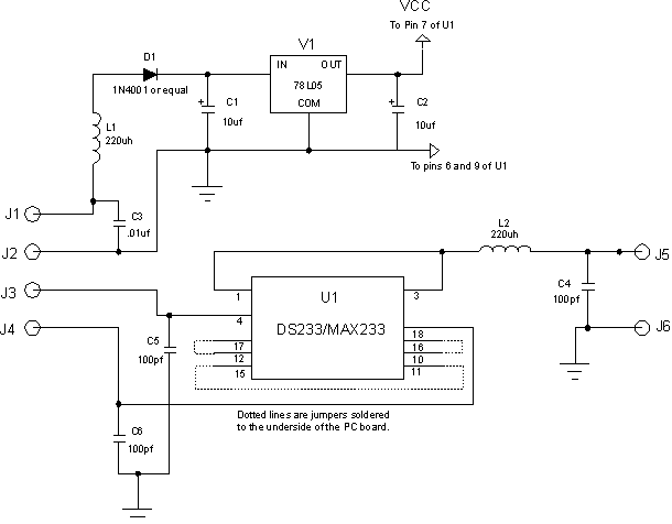

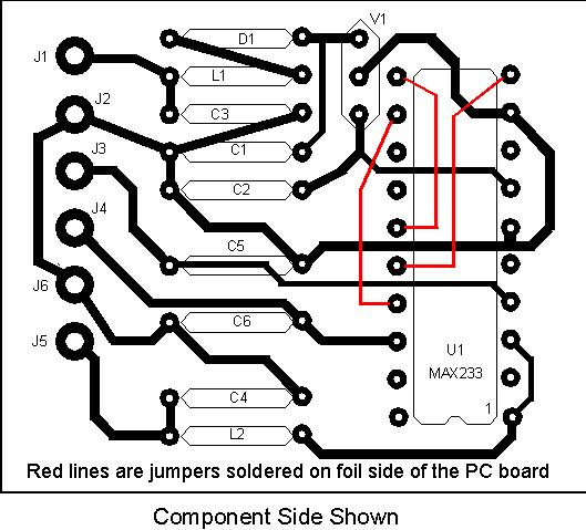

Icom CI-V Interface
Design by K4PWO
PC Serial Port, CI-V Interface and Radio Connections
RS-232
PC 25-pin Port
PC 9-pin Port
CI-V PC Board
Radio
*DTR
20
4
J1
GND
7
5
J2, J6
GND
TX
2
3
J3
RX
3
2
J4
J5
I/O
*Power is "stolen" from the PC's DTR line.  Some PC's (mainly laptops) do
not have enough current to power the interface.  In that case, you may use a
9 volt battery or other 9 to 15 volt source with positive to pin J1 and negative
to J2 or J6.  Also, a few older PC's swapped RX and TX on their serial ports.

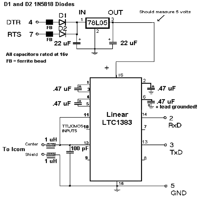

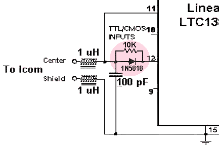

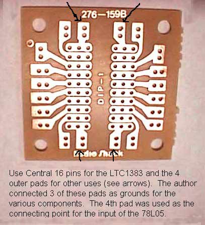

Icom CI-V Computer Interface For Computerized Rig Control or Loggin
Note: On the miniature electrolytics, the negative lead is the shorter lead and is marked with "0" in a white band

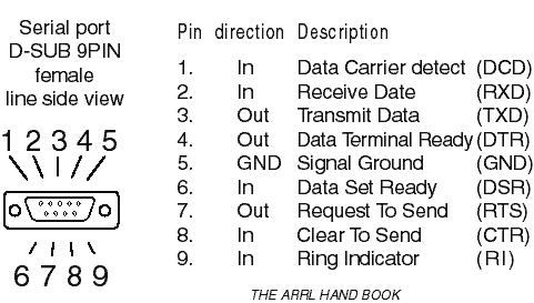

DB9 Serial Port Connections

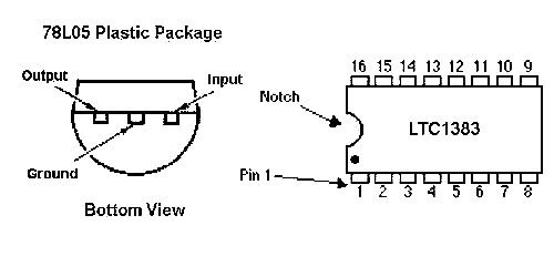

The DB9 serial port pin 2 is the RxD and is applied to the LTC1383 pin 14
The DB9 serial port pin 3 is the TxD and is applied to the LTC1383 pin 13
The DB9 serial port pin 5 is a common ground in the circuit
The DB9 serial port's DTR (pin 4) and RTS (pin 7) supply voltage to the input lead 1 of the 78L05 5 volt regulator. You should be able to measure +5 volts output between lead 3 (output) and lead 2 (ground) of the regulator (with a digital voltmeter!). Voltage is applied to pin 16 of the LTC1383.

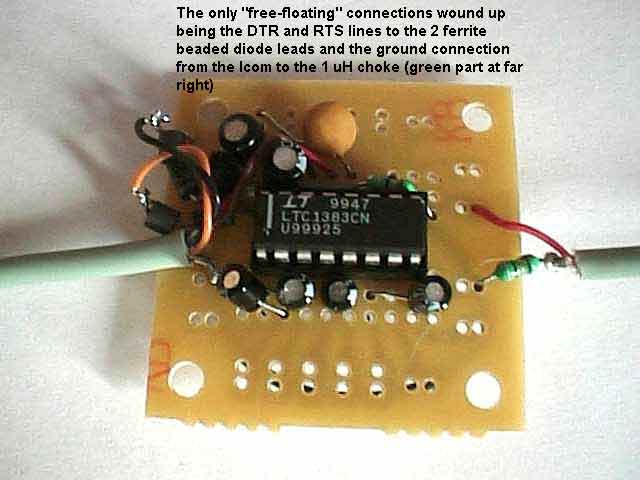

Theory of Operation
The ICOM CT-17 RS232 computer level converter is both costly and requires external power. By using a cheap, readily available ultra low power TTL to RS232 converter IC, the Linear LTC1383, one can make a self-contained unit, which derives its power from the serial port itself. Although the IBM PC serial port was designed without a DC power pin, early mouse designers figured out a way to squeeze some low-current DC power from RTS or DTR lines (or from BOTH in the case of the design shown above). The LTC1383 draws only about 220uA at 5 volts - far less than most mouse circuitry. The above circuit should work with just about any serial port, including some otherwise finicky PC laptop ports. The LTC 1383 IC does all the work and requires only 4 capacitors to charge the internal pump circuits. Although one can use tiny 0.1uf non-polarized caps for the 4 charge caps, I chose some 0.47uf miniature polarized radial electrolytics to be extra sure of speedy response times in the heat of DX J . All parts are available at the time of this writing online from RadioShack.com, but might be hard to find at the retail stores. I have no affiliation to Radio Shack, but enjoy their excellent website and variety of fairly cheap parts.
I chose to use some pre-punched general purpose DIP circuit board, a 16-pin DIP socket, 4 standoffs, 2 grommets and a tiny aluminum case to wire the circuit - which would add about $6 to the cost. Anal-retentive hams can etch and drill their own circuit boards! I'm sure some industrious hams will figure out a way to package the whole circuit inside a DB9 shell!

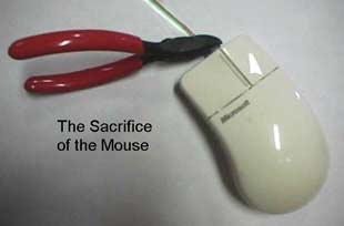

Instead of purchasing a DB9 female connector, I pilfered the connector and cable from an old broken Microsoft™ serial mouse. I not only got a "free" DB9 connector, but I found that the 4 conductor shielded cable used by the mouse already had my 5 connections made to the right pins! I even used a couple of feet of the same cable (after cutting off the 3 unused leads) as a single conductor shielded cable to run from the aluminum box to the 1/8 inch miniature phone plug for my IC-746. One builder found that he had a short in his mouse cable, so definitely test it thoroughly before using my mouse suggestion. If the thought of harming an innocent mouse is too hard to take, buy a db9 female and plastic or metal shell.
IMPORTANT: If you want to use a DB25 serial connector instead, remember that the ground pin is 7, DTR is pin 20, RTS is pin 4, TxD is pin 2 and RxD is pin 3! This would certainly give you more room in the casing to house the circuitry if you decide to go that route.
A note about the ferrite beads. Order two of part number 900-5005. I received 2 packs of 25 beads and wasted $0.25. But others have only received 2 beads and were happy that they ordered quantity "2"! So life is like a box of chocolates. You won't know what you get till you open the Radio Shack box.

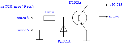

Схемы интерфейсов для управления трансивером ICOM смотрите в журналах: Игорь Лаврушов, UA6HJQ
Я собрал еще более простой интерфейс, так как мне не нужно было принимать информацию из трансивера в виде параметров в программу. Для управления трансивером используется программа ICOM-QSY.RAR.
