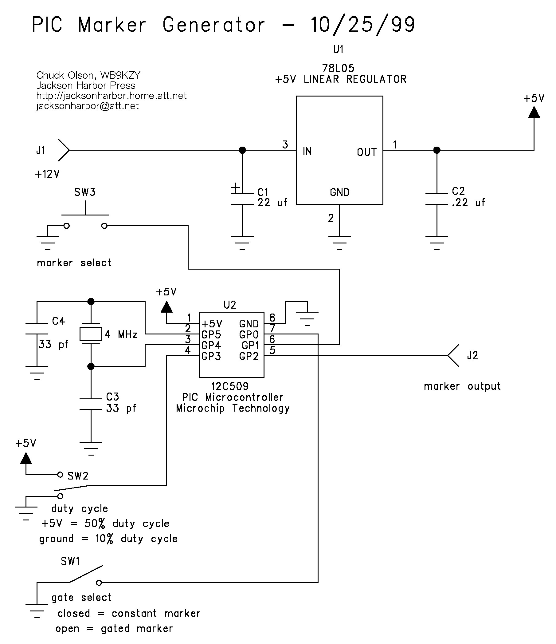

   This program uses a PIC 12C509 microcontroller to generate accurate
      square waves at frequencies of 100, 50, 25, 10 and 5 KHz.  When the output
      is coupled via a very small value cap to a receiver, the odd and even
      harmonics of these markers can be heard all the way through to 30 MHz.
      The markers are selected via a momentary push button switch closure to
      ground on pin 7.  At powerup, the PIC will output a 100 KHz signal to pin 5.  If the momentary switch is pressed and released (PAR), the
      the output will change to 50 KHz - subsequent PARs will advance down to the 5 KHz marker and then wraparound back to the 100 KHz marker.
       If pin 6 is grounded, the marker will be gated (turned on and off at
      a regular interval).  The frequency of the gating will increase as  the user changes the markers to allow easy identification of the marker.
      The 100 KHz marker has a slow on/off tone while the 5 KHz marker will have a very rapid buzz.
       If pin 4 is grounded, the duty cycle will change from the normal 50%
      square wave to a 10% square wave.  The idea was to even out the even and odd harmonic amplitudes, however, this isn't really accomplished
      but decided to leave it in anyway.  It may (depending on the frequency) increase the amplitude of the even harmonics slightly.
      Note that the pin should be connected either to ground or +5V directly - using the internal pullup or even an external 10K pullup resulted in
      a frequency shift of the marker.

       Hardware notes:
       (Click here for the circuit)
       I built a prototype on perf board - I had a little trouble with
      adjusting the 4 MHz oscillator to be right on frequency - the value of
      the caps or something else may need to be changed - one of the two 33 pf caps connected to the crystal should be variable trimmer
      cap to allow this adjustment.  It should be possible to use an external 4 MHz oscillator to drive pin 2 instead of using a crystal although
      I haven't actually tried this.

       PIC pinout:
| Pin | Name | Function / Connection |
| 1 | Vdd | +5V |
| 2 | osc1 | connected to the other side of 4 MHz xtal, also 33 pf to gnd |
| 3 | osc2 | connected to one side of 4 MHz xtal, also 33 pf to gnd |
| 4 | GP3 | duty cycle select - +5V = 50%, ground = 10% |
| 5 | GP2 | marker output |
| 6 | GP1 | marker select switch - normally open, internal pullup |
| 7 | GP0 | gate select switch - gnd = constant, open = gated, int pullup |
| 8 | GND | Ground |
