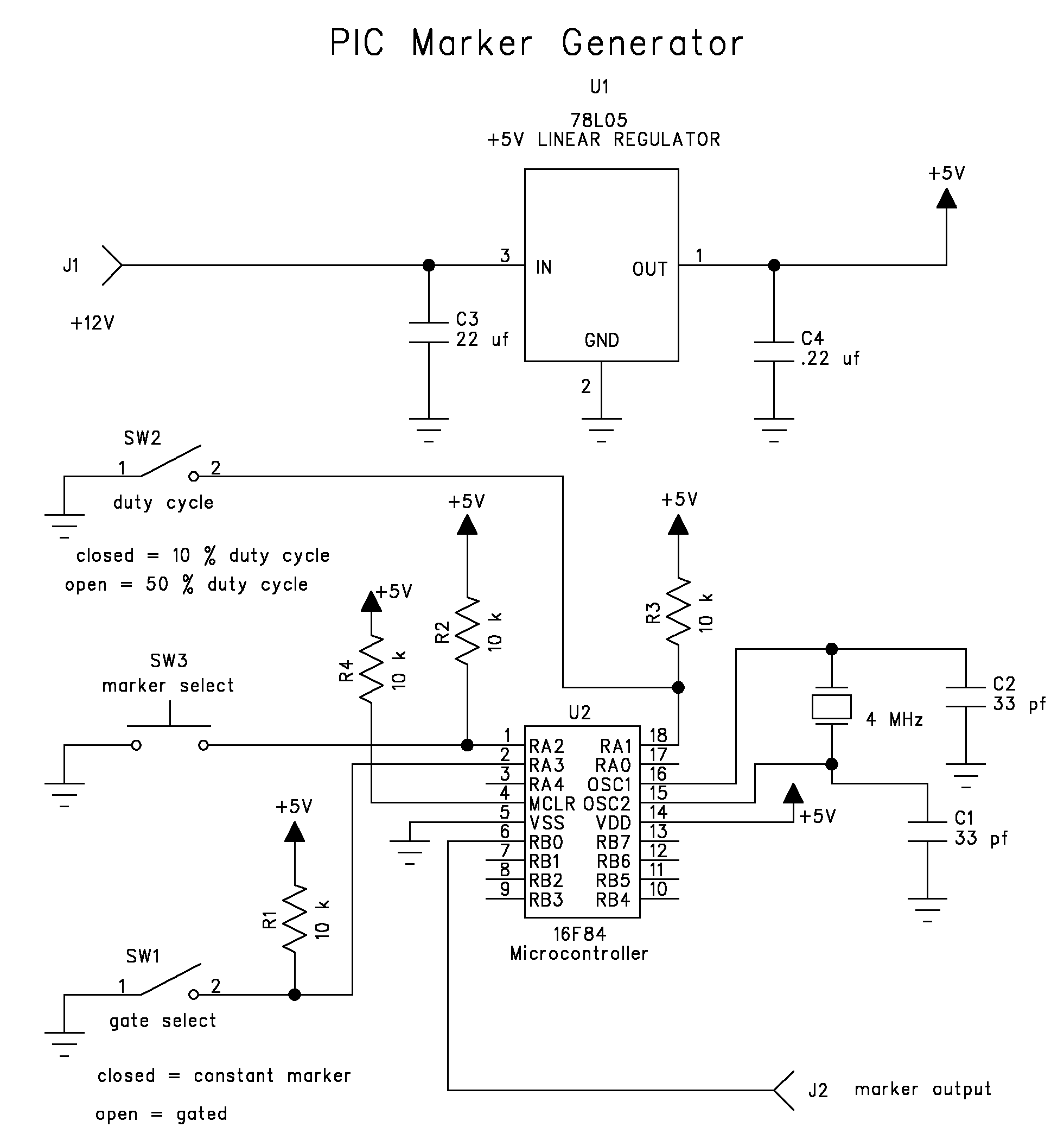

       Hardware notes:
       I built a prototype on perf board - I had a little trouble with
      adjusting the 4 MHz oscillator to be right on frequency - the value of
      the caps or something else may need to be changed - one of the two 33 pf caps connected to the crystal should be variable trimmer
      cap to allow this adjustment.  It should be possible to use an external 4 MHz oscillator to drive pin 16 instead of using a crystal although
      I haven't actually tried this.
      Click here for  schematic
      , sourse code

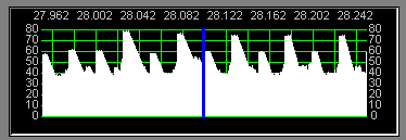

      Spectrum display of 25 KHz markers on 10M, 10% duty

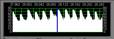

      Spectrum display of 25 KHz markers on 10M, 50% duty
      PIC pinout:
| Pin | Name | Function / Connection |
| 1 | ra2 | marker select, pulled up to +5V with a 10K resistor |
| 2 | ra3 | gate select, pulled up to +5V with a 10 k resistor |
| 3 | ra4 | no connect |
| 4 | MCLR | pulled up to +5V with a 10K resistor |
| 5 | Vss | Ground |
| 6 | rb0 | marker output |
| 7 | rb1 | no connect |
| 8 | rb2 | no connect |
| 9 | rb3 | no connect |
| 10 | rb4 | no connect |
| 11 | rb5 | no connect |
| 12 | rb6 | no connect |
| 13 | rb7 | no connect |
| 14 | Vdd | +5V |
| 15 | osc2 | connected to one side of 4 MHz xtal, also 33 pf cap to gnd |
| 16 | osc1 | connected to other side of 4 MHz crystal & 33 pf cap to gnd |
| 17 | ra0 | no connect |
| 18 | ra1 | duty cycle select, pulled up to +5V with a 10 k resistor |
