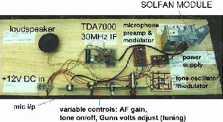

The photo above shows a "breadboard" version of the simple wideband 10GHz transceiver described in this article. The basis of the transceiver is the SOLFAN DOPPLER MODULE shown in the top right corner of the photo. This actual breadboard was used as a demonstration item at a lecture given by the writer to his local amateur radio club. Obviously you wouldn't use it in this form on a portable expedition into the hills! However, you can clearly see the several, simple boards that are added to the Solfan to make it into one of the simplest little rigs you could hope to make for the microwave bands.
If you make all the individual modules shown above, mount them all together in a metal box (an Eddystone diecast box is recommended). You then need an antenna and a support (eg tripod) to complete your 10GHz transceiver.... the choice is yours but some suggestions are given later.
IMPORTANT NOTE.........

Note also that the only "complicated" module in the photo above is the receiver IF. It is built on a purpose-made pcb. All the other units can be made on perforated stripboard (eg. "Veroboard") or built "dead bug" fashion on a small piece of single side pcb. The receiver IF shown in the photo uses a prototype of the board shown in more detail below. It might be possible to build the receiver on an unetched pcb, using the "deadbug" or "ugly" style of construction but the writer has not tried this and you might have instability problems. However it's worth a try!
Other Gunn oscillator/mixer modules can be used. The connections shown in Figure 2 will generally be the same but make sure that the Gunn module is "NEGATIVE EARTH".

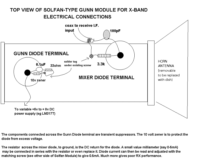

To put a Solfan doppler module
  into amateur radio use:
Of course, lots of other ancillary circuits may be included, especially a small post amplifier stage between the receive mixer diode and the IF unit. This provides a better match between the 200 to 300 ohm impedance of the diode and the input impedance of the IF (usually 50 ohm). These can come later though... you'll have plenty to keep you busy from the start!

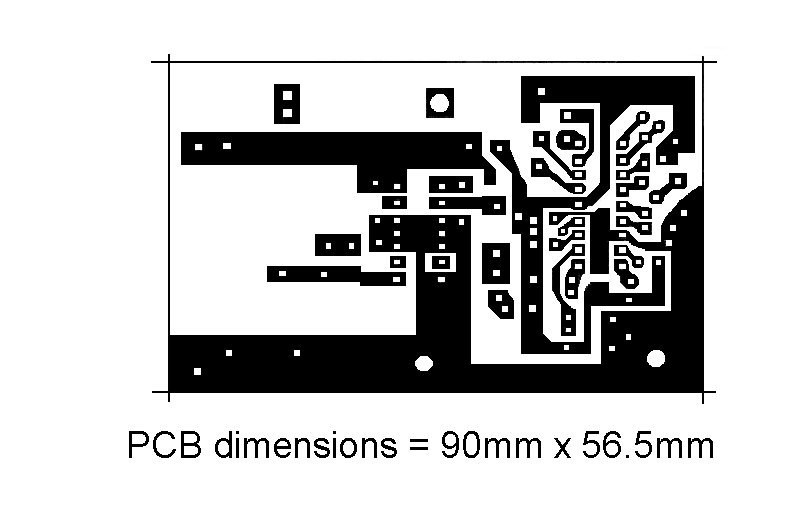

The 30MHz IF receiver described here will give
  very good results and is recommended to anyone who can get the PCB made for
  them. The art work for the pcb is also provided. It can be saved as a GIF graphic
  file and scaled to the dimensions shown by using a graphics software package
  such as Paint Shop Pro or Corel Photo.

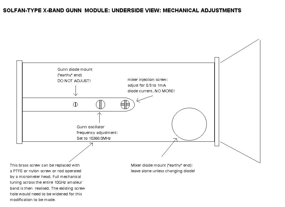

The following two diagrams show the general construction of a Solfan Doppler module, together with the components that are usually found soldered to its various terminals.
In the diagram above, the capacitors are all small disc ceramic types.

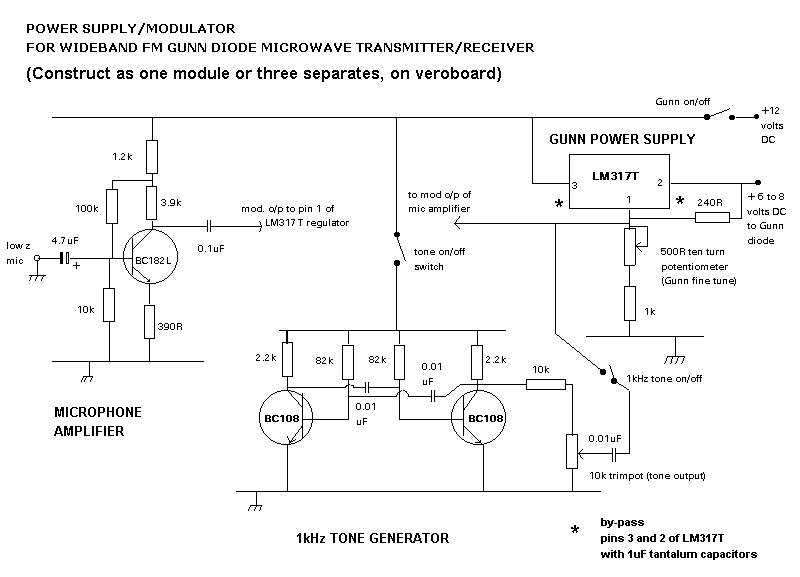

POWER SUPPLY/MODULATOR/TONE OSCILLATOR CIRCUITS:
If you cannot obtain BC182 or BC108 transistors
  you can use 2N2222 types throughout.
  The 1uF tantalum capacitors should be soldered as near as possible  to
  the LM317T input and output pins.
It is also worthwhile fitting protection against accidental input voltage polarity reversal (not shown in the circuit here).
The LM317T output (a variable voltage modulated
  by microphone audio or a 1kHz tone at the flick of a switch) is fed directly
  to the Gunn diode + terminal.

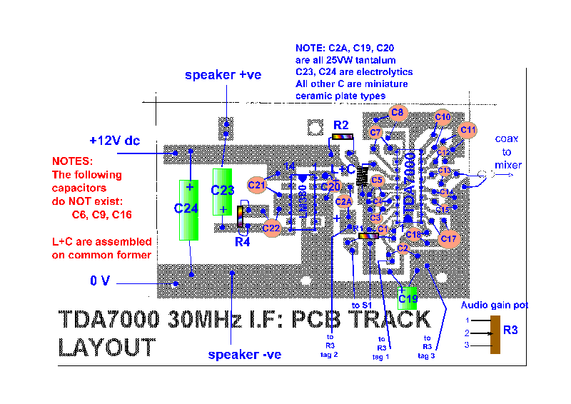

A 30MHz RECEIVER I.F. (based on the TDA7000 FM receiver IC):
  FIGURE 4:
  Please note: There is no C16 in the above circuit.

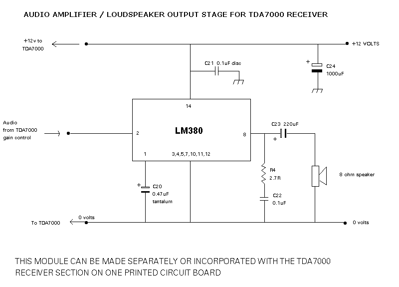

For full loudspeaker audio
  an LM380 audio amplifier chip is used in the following circuit:
The PCB layout below combines the TDA7000 IF with the LM380 audio amplifier to produce a complete 30MHz receiver, suitable for use as a "back end" to the 10GHz Solfan module:
The parts layout for the above PCB can be seen below:
