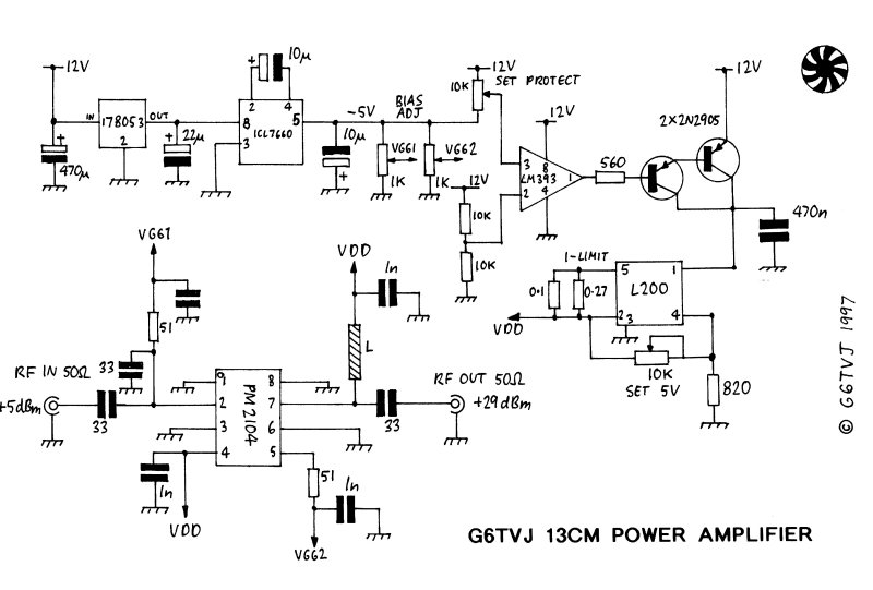

All the clever stuff is done inside the PM2104 IC, fig 1 shows the circuit diagram of the amplifier. The bias supplies and positive supplies are decoupled, some 50R matching resistors and a 33p cap are also required. The device is nominally pre-matched to 50R but a 33p matching cap is needed at the input pin.
The device is powered on pins 4 and 8 with 5V. Negative bias is supplied to pins 2 and 5. An ICL7660 DC to DC converter chip is used to generate the negative supply in a similar manner to what is used in some of the Microwave Committee 3cms units. A simple comparator circuit is used to detect the presence of the bias supplies and then switch on the +5V VDD supply to the IC. If the bias voltage fails the IC may be destroyed so the comparator is needed to protect it. As a second measure the L200 5V regulator incorporates a current limit set to about 600 mA, I have not proved the action of this circuit but after the touch and go action of soldering the IC in and the £40 whole in my pocket I thought I would put it in.

The bias generator, comparator, and regulators can be built on stripboard as convenient, only mild heatsinking is required. A standard fibreglass double sided PCB is etched to the pattern shown, the layout comes from the manufacturer’s data sheet. The base of the IC is metalised and must be soldered down to the board to form a heatsink. First tin the underside, solder down the pins and finally solder down the base by applying the iron to each side. The operation of mounting the IC is very tricky so not recommended for people without previous experience of working with surface mount devices. The other components can be added including several via pins which help earth the device. The PCB is then mounted in a tinplate box and fitted with SMA connectors in a similar way to how the RSGB microwave committee 3cm amplifiers are constructed.
The data sheet suggests that pin 2 should be set to -1.2V and pin 5 set to -1.5V, it is best to start with more negative bias and reduce them carefully while monitoring the supply current and power out. It is worth checking the action of the L200 current limit first with a dummy load. The protection circuit can be set up by adjusting the protect pot until the VDD supply just switches on (Best done before connecting the VDD supply to the 2104). I found that I could get the best efficiency with slightly different values of bias. By comparing the DC power in and RF power out the bias can be tweaked for minimum power dissipation of the PM2104. The values I ended up with were -1V and -2.2V for pins 2 and 5 respectively. The attainable output power should be up to about 800mW, +29 dBm with 5 mW of drive. The PM2104 runs warm to the touch in operation.
