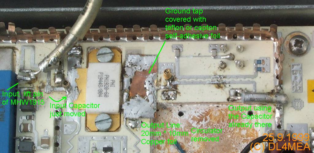

There are three versions of the HPA, which can easily differed when you check for the power module beeing used. You have to open the tin plated box which covers the amplfier:
GSM: Valvo/Phillips BGY915
DCS: Motorola MHW1815
PCS: Motorola MHW1915
I already convered successfully a PCS-HPA to 13cm. I tried to convert a GSM-HPA to 23cm but it failed.

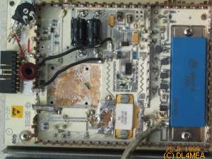

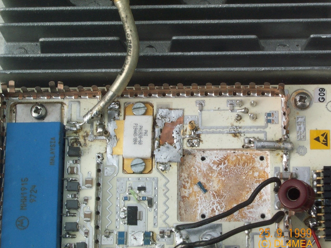

After the conversion the Mitsubishi-Module will not be used, simply the output transisor. There are simply a small piece of copper foil 20mm x 10mm and a small piece of self-adhesive teflon or capton foil needed.
Technical data after modifikation:
| Frequency | 2320MHz |
| Power Consumtion: | 5V/500mA 26V/6A |
| Output Power: | 1W in -> 9W out 5W in -> 40W out |
Due to lack of drive power I was unable to check for the maximum output power.

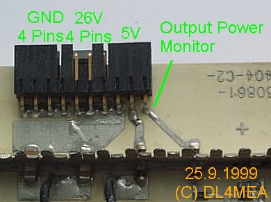

Power Supply Connector:
|  | With regulating the 5V supply you can set the idle current in the easiest way. |

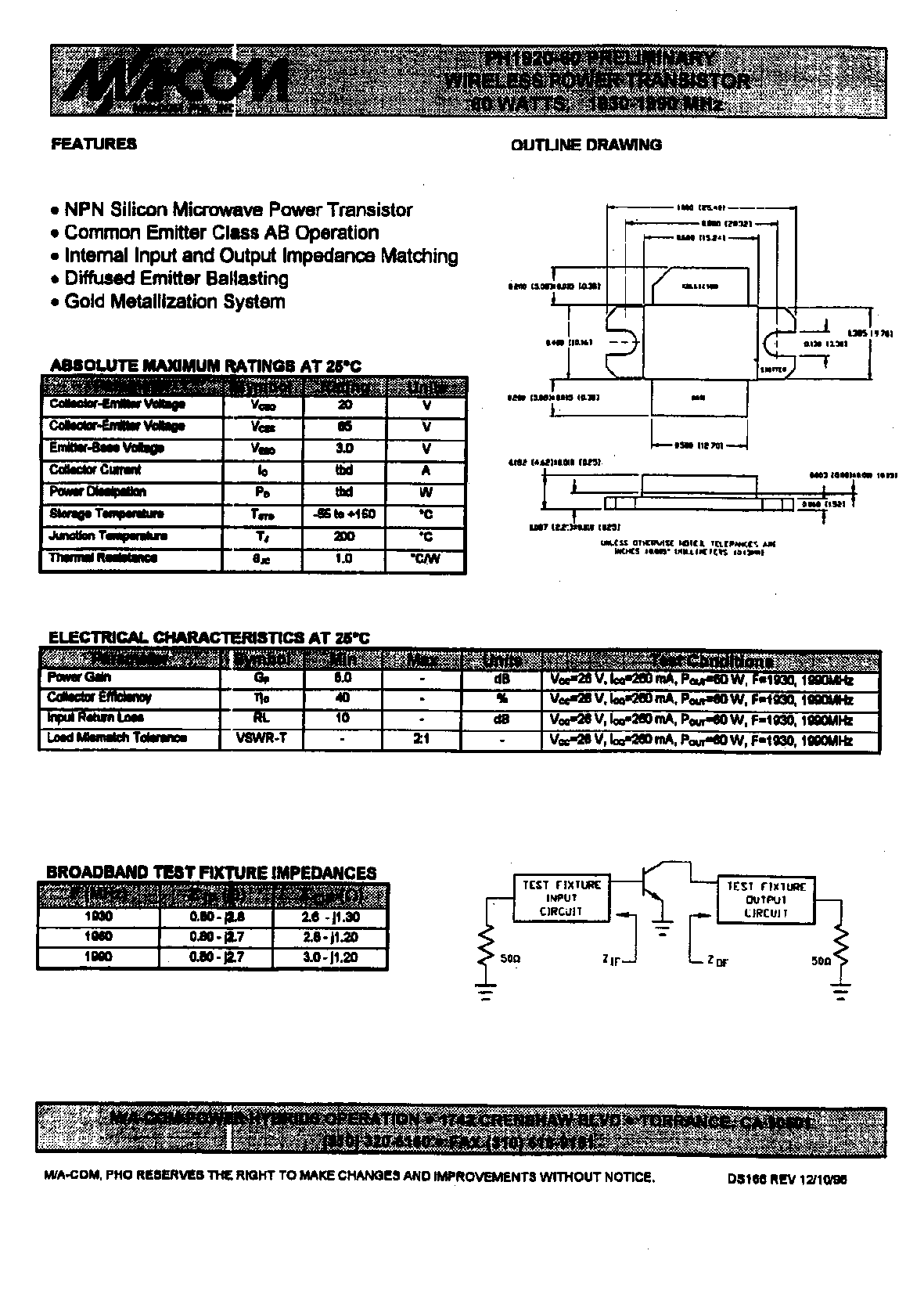

MA/COM PHI1920-60 Datasheet (60k)
