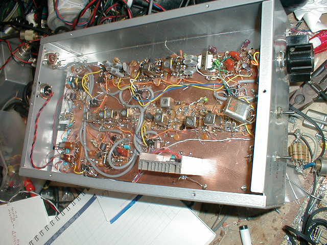

  The whole Construction : You can call the transceiver like this as "OZL
  type". Characteristics of the "OZL type" are as follows.
  1. Single conversion super.
  2. Using two DBM-s as modulator and converter.
  3. Modulator DBM is used as demodulator in receiving time.
  4. All amplifiers are used in transmitting and receiving time.
  5. Case is second use of my failed or useless machine.(This time I used my useless
  old 10W 7MHz transmitter.)
  6. All decals are done with the "Magic ink". Very simple way!
  7. Normal "OZL type" uses 12V DC power from cigar lighter of the car.

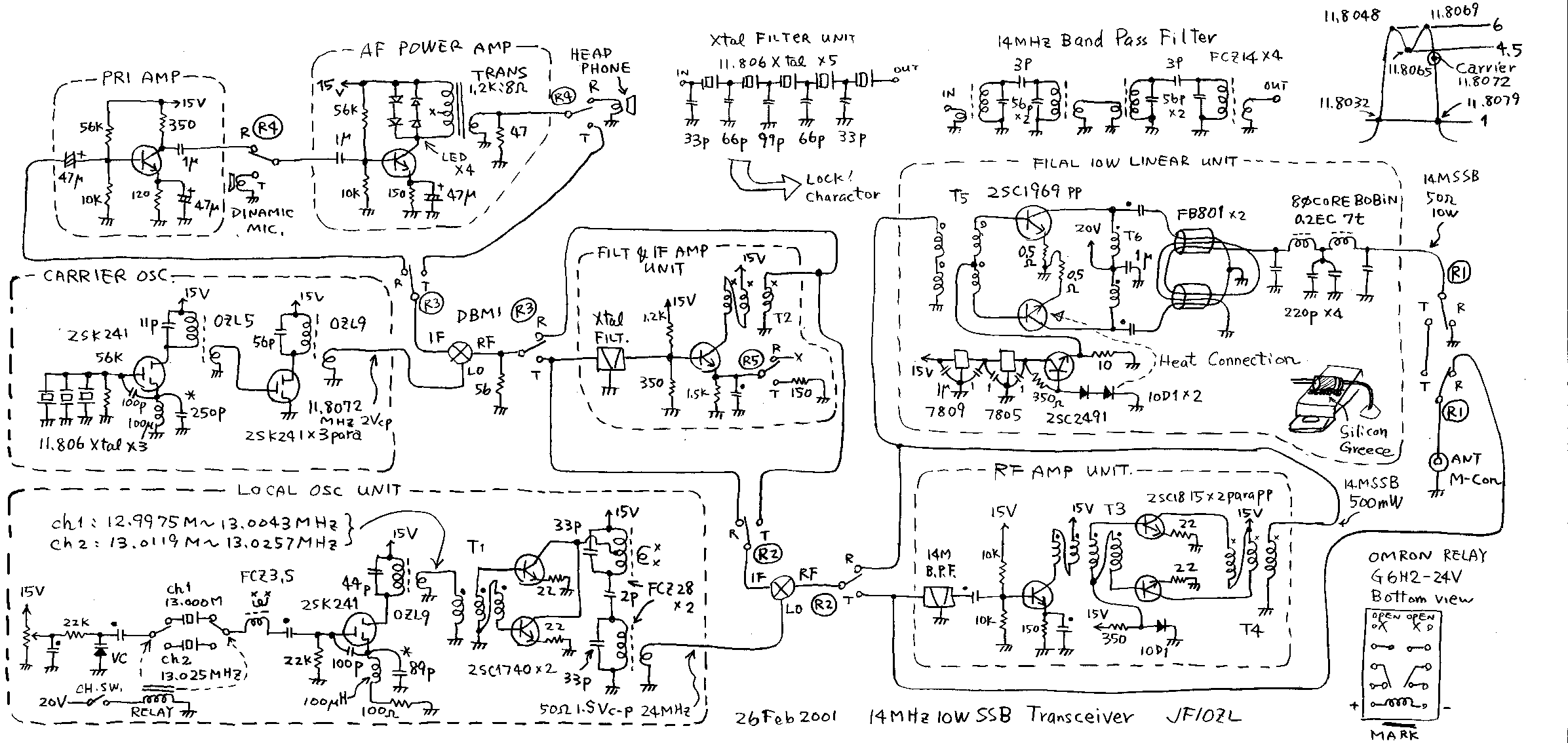

  Explanation of the circuit diagram:
  1. The black circle marked capacitor is 0.01 micro F ceramic capacitor.
  2.You should adjust the snow marked two capacitors on the oscillators to be
  got the maximum each output power.
  3. All NPN transistors who has no mark are 2SC1815. Maker: Toshiba. Usage :signal
  amplifier. Pc=0.4W, Vcbo=60V, Hfe=70 to 700, ft=80MHz.. I show you the character
  of another transistors as follows. 2SC1815:maker=Toshiba:usage=amp:Pc=0.4W:Vcbo=60V:Hfe=70to700:ft=80MHzmin///
  2SC1740:maker=Rohm:usage=universalamplifier:Pc=0.3W:Vcbo=50V:Hfe=120to820:ft=180MHz///
  2SC2491:maker=Sanken:usage=powersalamplifier,switching:Pc=50W:Vcbo=100V:Hfe=unknown:ft=30MHz///
  2SC1969:maker=Toshiba:usage=CB bandRFpoweramplifier:Pc=20W:Vcbo=60V:Hfe=unknown:ft=unknown,
  (Po=18W,at27MHz,Vcc=12V,Pi=1W)
  4. FET used on carrier oscillator is 2SK241. Maker Toshiba. Mos FET. Usage =FM
  VHF amplifier. Id=30mA, Pc=200mW, Idss=1.5 to 14mA, gm=10mS, Crs=0.035pF, PG=28dB
  on 100MHz.
  5. FIve micro relays named "G6H2-24V" are used as switching the connection
  of the circuit, from receiving to transmit. This relay is made by Omuron Co,.
  in Japan.
  6. T1,T2,T4 are FB801 tri -filer 2turn with 0.2mm diameter enamel wire.
  7. T3 and T5 are FB801 deca-filer 2 turn. Deca filer means the transformer made
  with four wires.
  8. T6 is FB801 double filer 2 turn. Double filer means the transformer made
  with two wires.
  9. Low pass filter are made with the coils "8.0mm diameter bobbin, 0.2mm
  EW 7 turn." This is designed as a Pie type low path filter with Q=1 frequency
  is 14MHz.
  Block diagram of trnsmitter
  signal flows left to right
| dinamic microphone | audio amp | DBM1 as modulator | 11.806Mhz DSB signal | crystal filter makes it to LSB | IF AMP | DBM2 as convertor | 14MHz USB | 14MHz BPF | 3stage HF AMP | LPF | ANT 14MHz USB 10W |
| upper | 26MHz go upper | ||||||||||
| carrier oscillater 11.806MHz | buffer AMP | 2channel VXO 13MHz | pusu-pusu doubler |
 Signal flow on transmitting time:
  1. I use 600 ohms dynamic microphone. It generates 50mVc-p signal with my voice.
  This audio A- class amplifier has 30dB voltage gain. Therefore my voice becomes
  over1Vc-p signal on it's outside. LED diode clipper is used to limit the amplitude
  of the outside of the audio amplifier for 250mVc-p. LED 's inner impedance become
  low when its voltage becomes over 2 volts. Four LED's are connected parallel
  series. Therefore the amplitude of the first side of the audio output transformer
  cannot be 4Vp-p. This audio signal is used to modulate the carrier in the next
  stage.
  2. Carrier oscillator is constructed with 11.806 named crystal and FET. It oscillates
  11.8072MHz actually. In order to generate the frequency on the upper slope of
  the crystal filter , this oscillator shall be tuned at this frequency. In this
  case I had to use FET only on this circuit. With transistor I could not tune
  the frequency on 11.8072MHz. When I made D-G pierce oscillator the frequency
  became higher than 11.808MHz. I changed the oscillator circuit to G-S pierce
  circuit. Then it oscillated 11.805 MHz. I changed the two crystals parallel
  , the frequency became 11.806MHz. I got 11.8072MHz by connecting three crystals
  parallel. In order to drive the double balanced modulator (DBM) as it's requiring
  local port signal strength , that is over 1mW, I had to set the buffer amplifier
  between the local oscillator and LO port of the DBM. This buffer outputs 2Vc-p
  signal. It is enough strength to drive the four diodes of the DBM and not to
  be disturbed by the audio signal on RF port of DBM. LO port carrier signal have
  to be strong more than 10dB than the modulating signal of RF port, to ensure
  the correct action of the modulator. Or else , the modulated signal becomes
  " over modulation".
  3.Please look another page of my home page about the construction and action
  of DBM. Here I used four silicon signal diodes named 1S1588(Toshiba Co,.). And
  also I used a pair of ferrite core named FB801, to construct each double balanced
  mixers. Here this DBM1 is used as a modulator. Here the 11.8072MHz CW signal
  is modulated by the audio signal. On the IF port of this DBM1 happens (comes
  up) the carrier suppressed double side band signal. You can see the 56 ohm resister
  on the IF port of the DBM1. It is used to shorten the output impedance of this
  DBM, not to be over 56 ohms. Without this resistor , the carrier suppression
  become 20dB worse. With this resister the carrier suppression are achieved as
  about -40dB.
  4. Because the carrier frequency is located on the upper slope of the pass band
  of the crystal filter, only lower side band of the double side band signal on
  the IF port of the DBM1 can be pass through crystal filter. Upper side band
  signal is rejected to path through the crystal filter.
  5. This lower side band signal (LSB) is amplified with the IF amplifier. The
  LSB signal came out of this amplifier is 400mVc-p with 50 ohms load.
  6. In order to get the wanted 14Mhz USB signal from this 11.8MHz LSB signal,
  26MHz CW signal shall be used. The calculation is " 26MhzCW -11.8MHz LSB=14.2MHzUSB".
  Please remember that "when the mixer generates the difference of two input
  signals, the USB changes LSB, LSB changes USB", and, " when the mixer
  generates the sum of the two input signals , USB became from USB, LSB became
  from LSB". I have about 5 kg of crystal ( several hundred). I chose from
  this stock the crystal named 13.025MHz. With this crystal VXO ( crystal controlled
  frequency tunable oscillator) is constructed. It generates from 13.0119 to 13.0257
  MHz. This signal is doubled with a push - push doubler. The output of this buffer
  amplifier is from 26.023 to 26.0514MHz1.5Vc-p CW signal with 50 ohms load. This
  signal drives the LO port of the DBM2.With This local signal I can make 14.2166
  to 14.2442MHz as it's transmitting frequency. Yes It can be used on the SSB
  band. But I want to make about 14.18MHz in order to get many chance to meet
  the Japanese domestic stations. Therefore I requested to ham shop to send me
  13.000MHz crystal. With using this crystal, I could oscillate 12.9975 to 13.0043MHz.
  I can QRV from 14.1878MHz to 14.2014MHz with this crystal as indicated channel
  one on the circuit diagram.
  7. On the DBM2 , 26MHz CW and 11.8MHz LSB signal is mixed. And the 14.2MHz USB
  signal is obtained(got) on the RF port of the DBM2. Here the signal rebels of
  the local port and IF port shall be compared. Anytime the LO port shall be driven
  stronger then IF port more than 10dB.
  8. Already I got 14.2MHz USB signal. This signal is amplified by the Radio frequency
  (RF) amplifier unit. The first step of the RF amplifier is made of A class single
  amplifier. The second step of the RF amplifier is constructed by the B- class
  push- pull amplifier. In order to stabilize the bias of final amplifier the
  power diode 10D1 is used with a 30mA of bias current. Here shall not to be used
  the small signal silicon diode like 1S1588. Please remember that " With
  more current on the bias diode, more stable of the bias circuit is achieved".
  T3 is made from four wire transformer. Instead of T3, two tri- filer transformers
  can be used. But T3 is more save resources type. ( But to make such a hand made
  rig with myself is not "save resources type action" as itself. Anyway
  the amateur radio is the "King's hobby", effective only to spend money
  and time)....On the front of the RF AMP unit , the 14MHz band pass filter is
  located. This filter reject to income some unwanted signals coming to RF AMP
  unit. On the end of the RF AMP unit, 14MHz low pass filter is located. It prevents
  to go out the unwanted harmonized signal born in RF AMP unit. Without this filter
  , this rig may cause the TVI , we call "I- chen" in Japanese. This
  filter is required by the government to allow to use the rig as a machine of
  amateur radio.

  port of the DBM1. This process is called as the demodulation.
  5. This demodulated audio signal is amplified by the audio amplifier. And it
  is heard with the head phone. In receiving time pri-audio amplifier is add to
  audio power amplifier to get more total gain. And the audio is heard with head
  phone.
  The result of this transceiver:
  I made nine QSOs with this rig and 14MHZ dipole antenna on the berranda of my
  house about 10M high. Please look the end of this page ! I made contact with
  another aria in Japan from my house located in Tsuchiura city. 14MHz can be
  used only from 10 o'clock before noon to two o'clock after noon for domestic
  communication. But I feel I would have Yagi antenna!!
