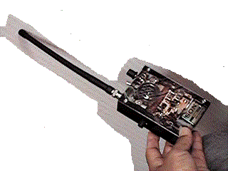

One day on the 50MHz SSB-QSO, my
    friends JE3TXU/1 (Mr.Haraguchi) sad to me that he made 50MHz very small transceiver.
    I said to him that he shall inform about it on the Japanease CQ magazine.
    You can see about it on the book.
    Then I had made some shoulder type sized transceiver. But I had never made
    handy. Therefore I decided to make it.

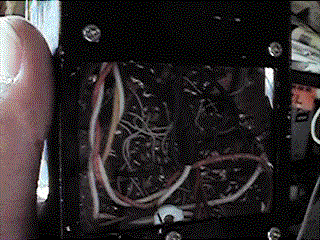

    See the photo! This rig is made by a surface mount construction. All transistor
    and resistor is made by surface mount chips. So this is very small. But as
    you can see on the photo , many wires run on the surface of the print board.
    My younger brother said to me that it looks like noodle(RA-MEN). So I gave
    up to show it on the ham fair handmade booth.

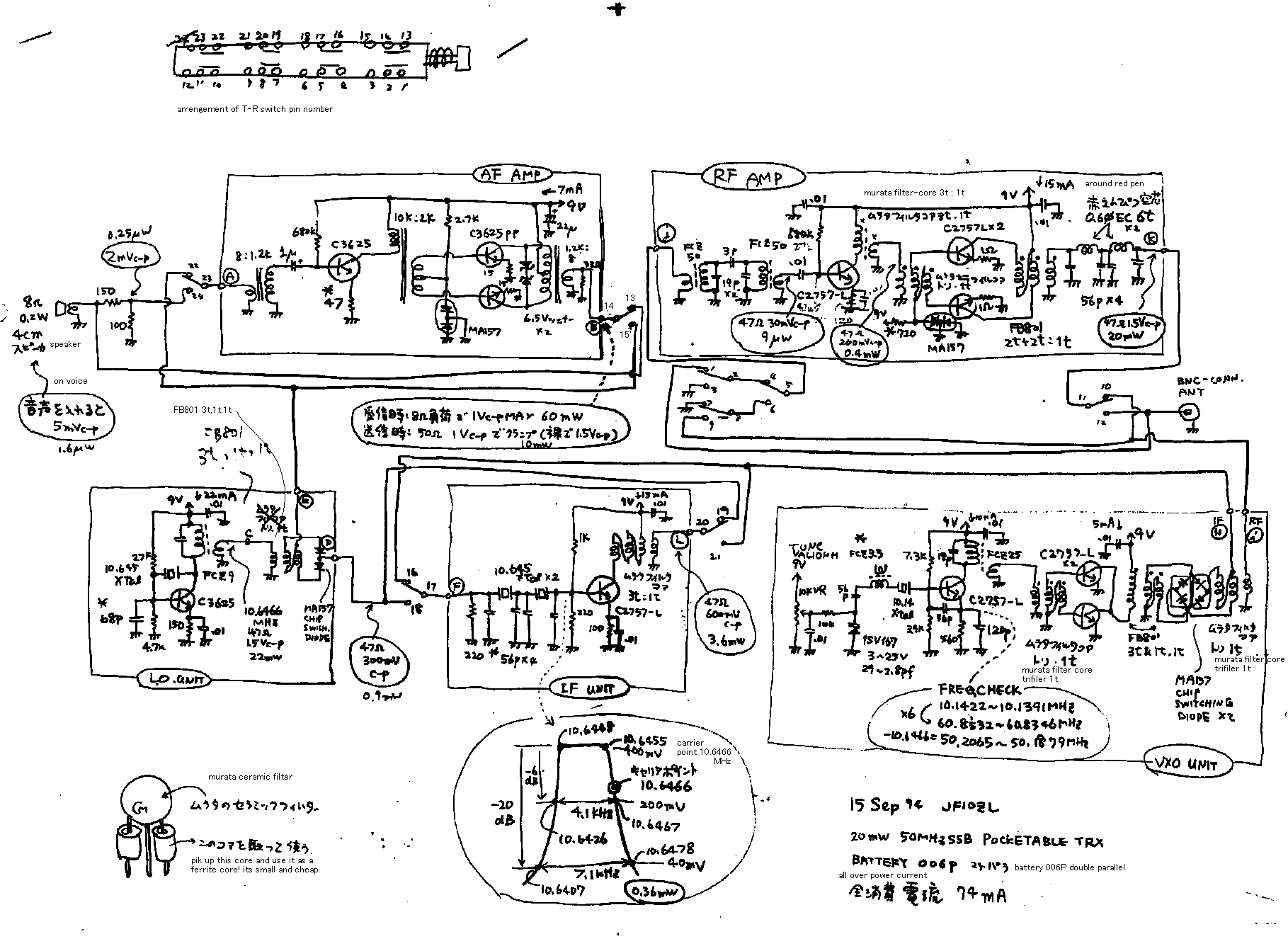

    Circuit of it is similar as it of 50MHz 2W TRX. So I will show you only the
    circuit. About explanation, please read it.
    In order to make a beautiful handy transceiver, it is more important that
    " to spare the wire connections " than " to spare the circuits".
    You know?HIHI !!
