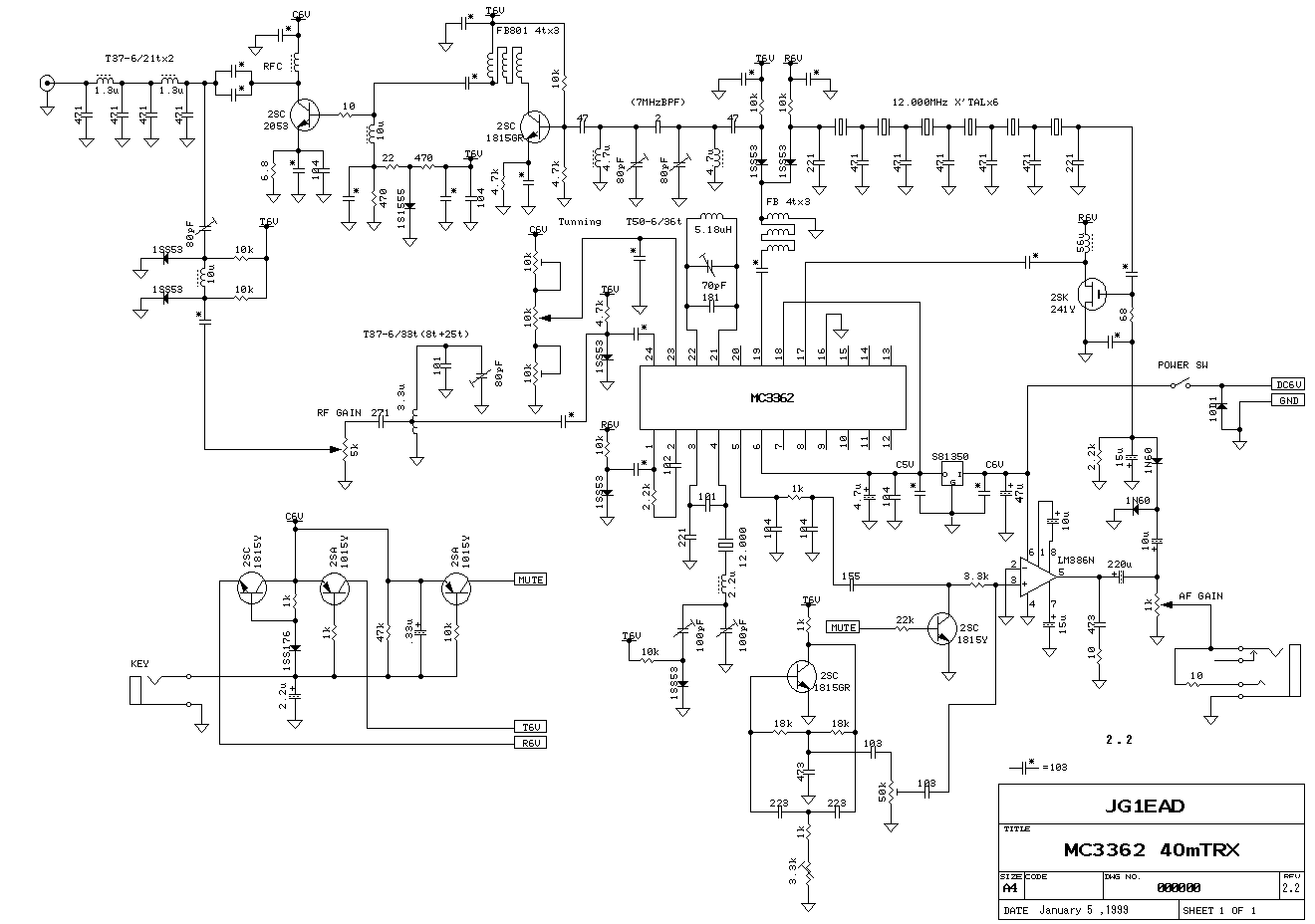

        MC3362P. I made a 7MHz CW transceiver by using the IC for the narrow band
        FM double super receiving circuit, MC3362P. I intended to make a transceiver
        for 10MHz band in the beginning. But, I was worried by the neighboring
        spurious signal which wasn't expected, and I changed the plan. I changed
        frequency to 7MHz band, and continued the production, and completed this
        transceiver. The CW transceiver made by MC3362P was introduced to the
        QST journal of December, '90 and January, '91 as well. (The article of
        the translation of selected passages appeared in August, 91 issue of the
        JA-CQ journal as well.) Because 2 set of double balanced mixers and local
        oscilators are built in this IC, it is suitable for the single super heterodyne
        receiver of SSB/CW. I made the whole circuit scale compact by using the
        1st mixer of the receiving circuit as the mixer for the transmission as
        well. I am only using 2 transistors of the transmitting output stage,
        1 FET of the reception AGC, NJM386(second source of LM386) and 4 transistors
        such as the transmitting-receiving switch, except for MC3362P. But, though
        it is very much disappointed, it seems to finish the production of MC3362P
        by the end in 1998. (The Motrola company recommends MC13135 as the substitut.)

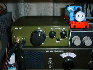

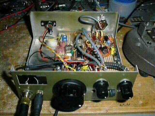

 I included this transceiver into the case of 'P-7' which
        was kit of the Mizuho company. As for being reflected by the photograph
        of the upper front panel, a slide switch under that is a power switch
        with a stereophonic headphones jack, a key jack, a VFO knob, RF gain,
        AF gain from the left. It is the power supply connector of DC6 - 9V and
        a M-type antenna connector that it is reflected by the photograph of the
        rear panel.

 Circuit
          schematic

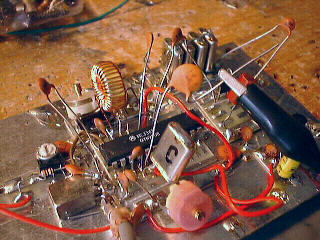

          In the middle of the
          experiment (June, 98)

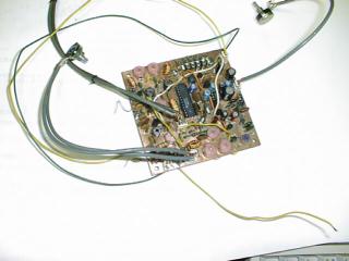

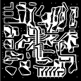

          The print circuit board made
          by JA1EIH, Mr. YANAGI
          After the installing a part in the circuit board
