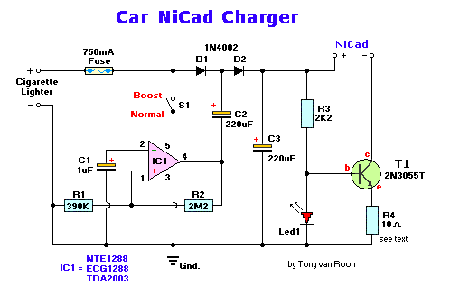

Car NiCd Charger

  This circuit provides up to 20V output from a regular 13.2V automotive battery,
  to enable constant current charging of nicad battery packs up to 15 cells @
  1.2V (18V total).
  IC1 is a Linear, Audio Power Amp (10W) and was orginally designed for car radios
  by Toshiba. Several replacement types can be used, like the ECG1288, NTE1288
  and other substitutes will work fine.
  In this circuit, with S1 set in the 'boost' position, IC1 is used to
  form a squarewave oscillator, and by coupling this square wave to the 13.2V
  battery supply via D1 and D2 to obtain over 20 vdc. If this is not needed, S1
  is left open (normal).
  T1 acts as a current regulator to determine the charge rate of the battery pack.

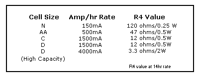

  T1 should be mounted on a sufficient coolrib. R4 is selected from the table
  below, or it can be adapted and switched with a rotary selector switch (watch
  current rating!).
  R4 can easily be adjusted for any value to suit your needs other than listed
  here.
