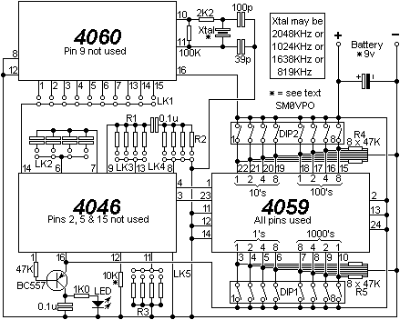

One of the most interesting projects to work with is that of a synthesizer that can accurately gnerate desired frequencies. This synthesizer uses just three CMOS chips and one PNP transistor. It is a fact that the transistor may be the hardest component to get in some parts of the world!! The synthesizer will generate a 3:1 frequency range anywhere from 300Hz to 4,000,000Hz (4MHz). Using the components shown you can feed the synthesizer with up to 12vDC but with only 9vDC the synthesizer may not achieve more than 3.5MHz. Tye lock-range of this synthesizer is about 10:1 or so.

The CD4060 reference oscillator divides a crystal reference oscillator sucessively by two. From each stage we can select a frequency that is half the value of the previous frequency. The reference frequency of the synthesizer is multiplied by the programmeable divider divide rate to give the final frequency. If our reference frequency is 1KHz then the final output may be programmeable in 1KHz steps. This is quite convenient for a decimal programeable divider. Divide by 1000 = 1000KHz, divide by 1001 = 1001KHz etc. You could also select a crystal that would give you a 100Hz output then you could select frequencies in 100Hz steps. Divide by 1000 = 100KHz, divide by 1001 = 100.1KHz etc. Here are reference frequencies you could use for different oscillator crystal frequencies.

The 4046 has a wide-range Voltage Controlled Oscillator (VCO) which uses C1 and R3 to determine the frequency. C1 is selected by LK2 and I used 33pf, 47pf, 68pf and 100pf. R3 is selected by LK5 and I used 4K7, 10K, 33K and 100K. The 10K resistor from pin 12 is an offset resistor which may be omitted. I only used it to push the VCO up to 4MHz which is about the maximum you will realistically get from a CD4046. The 74VHC4046 is supposed to go up to someting like 20MHz.

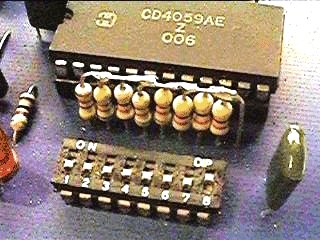

The output of the VCO is divided by a programmed figure in the 4059 IC. I just used two 8-pin DIP switches on the PCB but there is no reason why you cannot use "BCD thumbnail" switches. Each digit is in the form of Binary Coded Decimal (BCD) and so the range of each digit is 0 to 9. The 1000's digit however may be programmed up to 15 (F in hexadecimal) so the maximum divide rate is 15999. The minimum divide rate is 3 so that with a 100Hz reference oscillator the minimum output is 300Hz.

The reference oscillator and the output of the programmable divider are both fed into the twin phase detectors in the 4046. One of these outputs (pin 13) gives a HIGH, LOW or TRISTATE (high impedance) levels which indicates whether the programmable divider output is above, below or equal to the reference frequency. This is used to control the VCO frequency and complete the loop. There is a second phase detector but this is little more than an Exclusive-OR gate. I have used this to give a loop locked indicator via the LED and the BC557 (PNP) transistor.

The output of the phase detector is fed via R1 (10K, 33K, 100K and 330K selected by LK3) to a capacitor to form the loop filter. If the loop filter time constant is too short then FM modulation will be removed. If too long then it will take too long for the loop to lock onto a new frequency. There is also a dampling resistor R2 (1K, 3K3, 10K and 33K) which is selected by LK4. The loop damping resistor should be included to prevent loop over-correction. This would result in the VCO constantly swinging above and below the correct frequency.

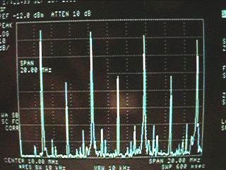

The PCB does not give any particular output socket since it was designed for training dealer staff and was only to be viewed with an oscilloscope. A high-level buffered output is available from pin 10 of the 4046 VCO but this must have a load resistor of 10K to ground. The output is a square-wave with odd harmonics extending throughout the HF spectrum. Here is a spectrum display from the prototype - 0 to 20MHz:

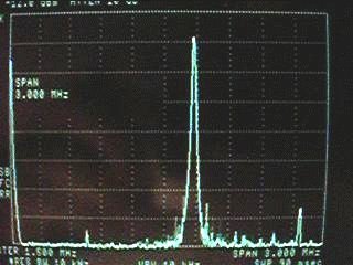

As you can see, there are both odd and even harmonics throughout the HF spectrum with the odd harmonics being the strongest. This means that you will need to filter the output if you intend to use it for transmitting or receiving. A closer view of the spectrum, also at 1.8MHz centre frequency shows the output to be relatively clean:

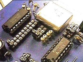

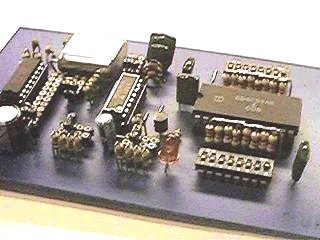

The completed synthesizer PCB is 108mm x 64mm and has only battery (and output?) connections. I fitted all three ICs to sockets even though modern sockets cost more than the CMOS chips (I am VERY old- fashioned, I even like to see girls in black seamed stockings!).
Because this unit was used for training I needed to adjust some of the settings so I used header sockets and U links. In this way I could select any clock frequency, VCO parameters and loop-filter settings I wanted.

I set the frequency by means of two eight-pin DIP switches. Note that the place values of the switches are 1 2 4 8 from left to right EXCEPT the fourth (most significant digit) which is backwards: 8 4 2 1.
Let us assume I want to generate the frequency 1.815MHz. With a 4.096MHz crystal I set the following links and DIP switches. Note that the MHz switch is backwards.
LK1 = 1KHz (Q11) LK2 = 33pf LK5 = 4K7
Loop filter LK3 = 100K LK4 = 10K
DIP-1 (5KHz) 1 & 3 = ON 2 & 4 = OFF
DIP-2 (10KHz) 1 = ON 2 3 & 4 = OFF
DIP-2 (800KHz) 8 = ON 5 6 & 7 = OFF
DIP-1 (1MHz) 8 = ON 5 6 & 7 = OFF

A printed circuit board is available but I drew the artwork before I had a computer so I used drafting pens with old fashioned ink on good old tracing paper. I have scanned my PCB Artwork which works, but I have not bothered to tidy it up. I have not yet drawn a component overlay as I think that it should not be too difficult for anyone of modest intelect to identify the component locations. Anyway, you can not complain, it's for free!!
