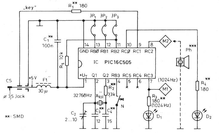

Fox hunting trcvr control unit
fox.asm - sourse code for PIC 16C505
(7 different fox in one)
Jumper Fox Code
3 2 1
0 0 0 none
0 0 1 MOE
0 1 0 MOI
0 1 1 MOS
1 0 0 MOH
1 0 1 MO5
1 1 0 MO
1 1 1 T

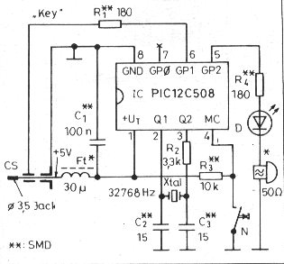

Available sourse codes for PIC 16C508:
fox1.hex
fox2.hex
fox3.hex
fox4.hex
fox5.hex
