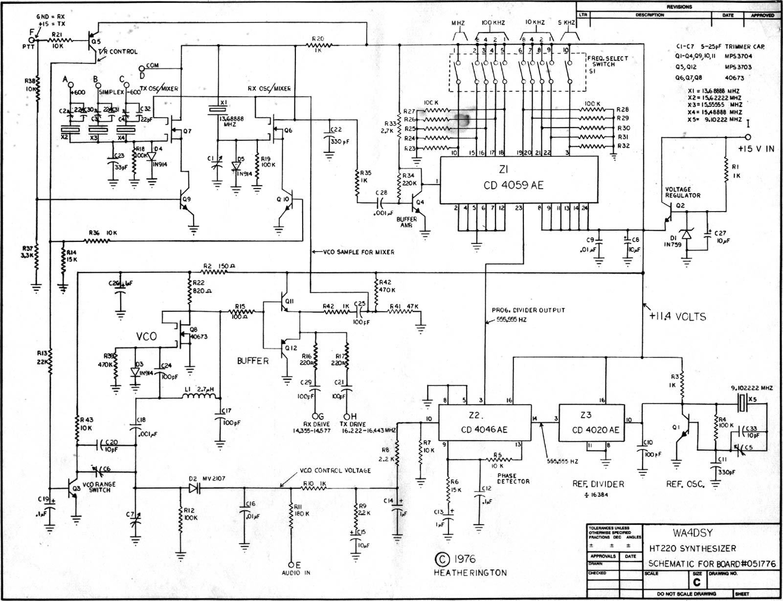

The following instructions pertain to the new board marked with the number 051776. There have been several improvements made over the old board. Most noteable is the reduction of receiver birdies and a 12 mA reduction of the power drain. Only 2 receiver birdies remain; 146.000 and 147.100 MHz. The transmitter spurious outputs are at least 5 dB better and the broad band white noise is down much more, The white noise reduction also resulted in improved receiver sensitivity. I still don’t recommend using a high power amplifier with the synthesized HT220 but if you feel the need to do so here is the formula to compute the 2 major spurs so you will at least know where your QRM is,
| Upper
        spur =  | F
        + ((F/9) - 15.5555) for simplex |
| F
        + ((F/9) - 15.4888) for -600 KHz | |
| F
        + ((F/9) - 15.6888) for +600 KHz | |
| Lower
        spur = | F
        - ((F/9) - 15.5555) for simplex |
| F
        - ((F/9) - 15.4888) for -600 KHz | |
| F
        - ((F/9) - 15.6888) for +600 KHz | |
| where
        F = operating frequency in MHz | |
| example: | F
        = 146.520 MHz simplex |
| lower
        spur = 145.796 | |
| upper
        spur = 147.244 |

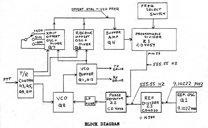

Another major improvement was the elimination of the two CD4011 ICs. Many people found it was hard to find CD4011s that would work right in the original circuit. That is no longer a problem since there are no CD4011s in the new circuit. Some people have ask why I used 9.10222 MHz for the reference frequency instead of 4.551111 MHz so the CD4020 reference divider would not be pushed to it’s limit. The answer is simple.... High accuracy crystals in the HC 18/U holder below 6 MHz are not available.

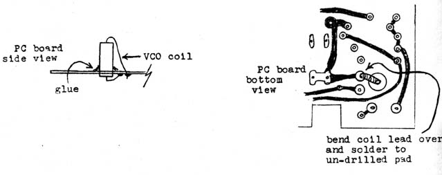

A word about IC sockets: You can use low profile sockets if you bond the leads that need to be soldered to the top side of the board out to the side so you can solder to them. Be careful that they don’t touch anything they should not.

Construction Hints
Because of the high parts density of this circuit, the procedures outlined below should be followed.

NOTE: If you have trouble with any of the test and alignment steps cheek for a 555.555 Hz square wave at pin 3 on Z3, CD4020. Some 4020s won’t work at 9.1022 MHz. If you have an input on pin 10 of this IC but no output on pin 3 you need to try another one.

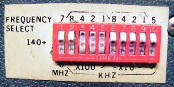

How to use the binary frequency select switch
This switch consist of 10 spst switchs numbered 1 thru 10. In the following discussion an "ON" switch will be called 1 and an "OFF" switch will be called 0. The frequency is entered directly in BCD code.
Switch #1 is the MHz select switch: 0 = 146.XXX MHz, 1 = 147.XXX MHz
Switches #2, 3, 4, 5 are the 100 KHz select switches. They are BCD coded and can select any digit from 0 to 9.
Switches #6, 7, 8, 9 are the 10 KHz select switches. They are also BCD. coded and can select any digit from 0 to 9.
Switch #10 is the 5 KHz select switch. 0 = 14X.XX0, 1 = 14X.XX5
Note: The following is in courier font so the numbers should align in proper columns.
BCD code for
    switches 2 thru 9
    BCD code, 0 = off, 1 = on
Switch number
    2 3 4 5 or
    6 7 8 9
    0 0 0 0 = 0
    0 0 0 1 = 1
    0 0 1 0 = 2
    0 0 1 1 = 3
    0 1 0 0 = 4
    0 1 0 1 = 5
    0 1 1 0 = 6
    0 1 1 1 = 7
    1 0 0 0 = 8
    1 0 0 1 = 9
    8 4 2 1 = binary weight
Examples:
MHz 100
    KHz   10 KHz    5 KHz
    1   2 3 4 5   6 7 8 9   10  switch
    number
0   0
    0 0 0   0 0 0 0   0 = 146.000
    0   0 1 0 1   0 0 1 0   0 = 146.520
    0   1 0 0 1   0 1 0 0   0 = 146.940
    0   1 0 0 0   0 0 1 0   0 = 146.820
    1   0 0 0 0   0 0 0 0   0 = 147.000
    1   0 1 1 1   0 0 1 1   1 = 147.735
Caution, when operating above 147.400 MHz be sure the transmit offset switch is in simplex or -600 KHz. If not the transmitter will transmit at 148 MHz or above.
Photo of DIP switch in back of a HT220 (image from a eBay item)
