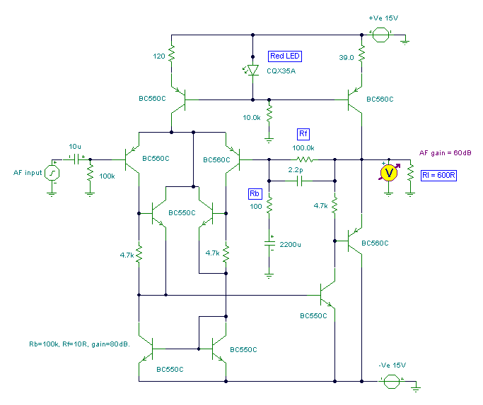

HI-FI AF Preamplifier
Notes:
This
circuit  has an exceptionally good high

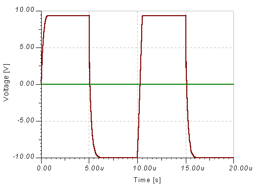

frequency response, as demonstrated by applying an 100kHz squarewave to the

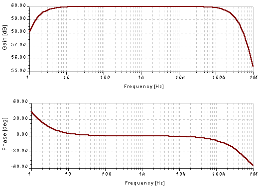

input. I have produced some response graphs using Tina Pro to highlight these
characteristics.
The Preamp's Frequency and Phase Response
Squarewave Response with 100kHz Input Applied

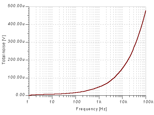

Total Noise at Output Measured with 600R Load

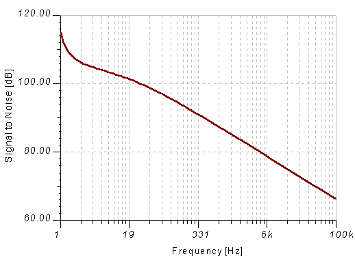

Signal to Noise Ratio at Output
