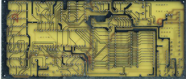

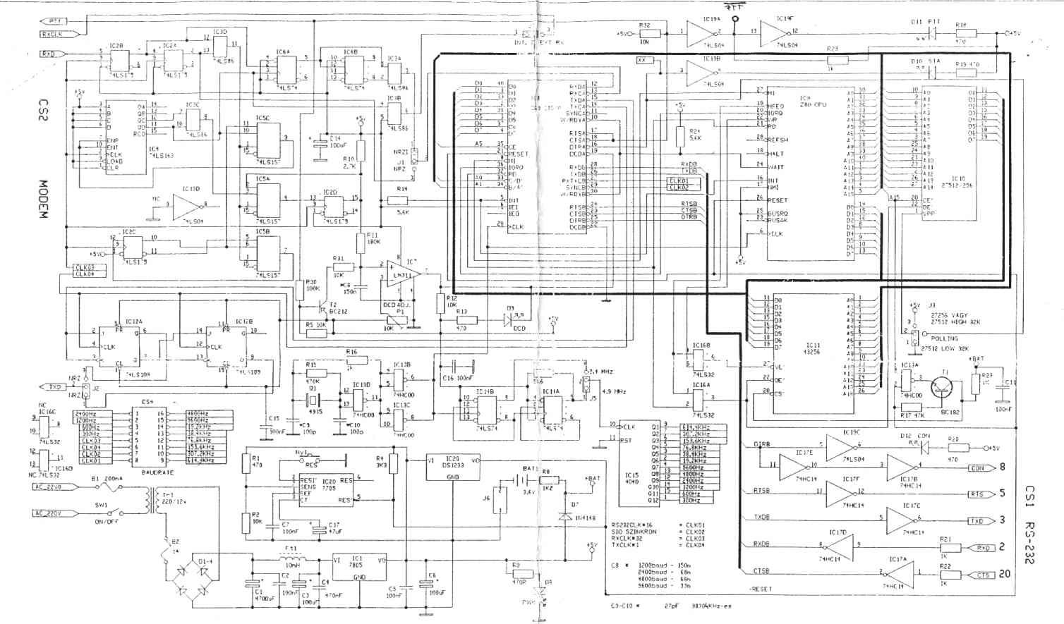

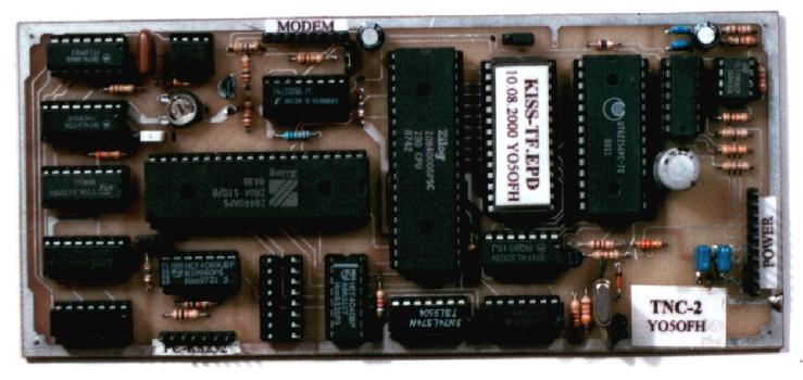

TNC2.000
- bord size (double sided PCB) : 180 * 80 mm
- power suply on board
- reset circuit with the special TL7705  IC
- 32K SRAM memory
- two selectable program with jumper in 27512 Eprom, or one program in 27256 Eprom
- NRZ or NRZI selectable with jumpers
- DCD circuit
- max. 38400 baud/s speed towards PC
- HDLC port towards modem
- capable to use a different modems with 300-19200 baud/s speed
- tested with different OS : DOS, Win9x, Linux
- tested with different packet radio programs: Graphic Packet, TstHost, Winpack, TsthWin, Vpacket, WinGT, XNET
     kiss.epr - 32768 byte for 27256 Eprom
     tf27.epr - 32768 byte for 27256 Eprom
     tnc2.epr - 65536 byte for 27512 Eprom
