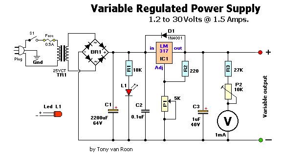

 Some Notes: This is a simple, but low-ripple powersupply, and an excellent
  project if you're starting out in electronics. It will suit your needs for most
  of your bench testing and prototype applications. The output is adjustable from
  1.2 volts to about 30 volts. Maximum current is about 1.5 amps which is also
  sufficient for most of your tinkering. It is relatively easy to build and can
  be pretty cheap if you have some or all the required parts. A printed circuit
  board is not included and I'm not planning on adding one since the whole thing
  can easily be build on perferated or vero board. Or buy one of Radio Shack/Tandy's
  experimentors boards (#276-150). Suit yourself. The meter and the transformer
  are the money suckers, but if you can scrounge them up from somewhere it will
  reduce the cost significantly. BR1 is a full-wave bridge rectifier. The two
  '~' denotes 'AC' and are connected to the 25vac output coming from the transformer.
  IC1 is a 3-pin, TO-220 model. Be sure to put a cooling rib on IC1, at it's max
  1.5 A current it quickly becomes very hot...

  Circuit Description: The 110V-AC coming from the powercord is fed to
  the transformer TR1 via the on-off switch and the 500mA fuse. The 30vac output
  (approximately) from the transformer is presented to the BR1, the bridge-rectifier,
  and here rectified from AC (Alternating Current) to DC (Direct Current). If
  you don't want to spend the money for a Bridge Rectifier, you can easily use
  four general purpose 1N4004 diodes. The pulsating DC output is filtered via
  the 2200µF capacitor (to make it more manageable for the regulator) and
  fed to 'IN'-put of the adjustable LM317 regulator (IC1). The output of this
  regulator is your adjustable voltage of 1.2 to 30volts varied via the 'Adj'
  pin and the 5K potmeter P1. The large value of C1 makes for a good, low ripple
  output voltage.
  Why exactly 1.2V and not 0-volt? Very basic, the job of the regulator is two-fold;
  first, it compares the output voltage to an internal reference and controls
  the output voltage so that it remains constant, and second, it provides a method
  for adjusting the output voltage to the level you want by using a potentriometer.
  Internally the regulator uses a zener diode to provide a fixed reference voltage
  of 1.2 volt across the external resistor R2. (This resistor is usually around
  240 ohms, but 220 ohms will work fine without any problems). Because of this
  the voltage at the output can never decrease below 1.2 volts, but as the potentiometer
  (P1) increases in resistance the voltage accross it, due to current from the
  regulator plus current from R2, its voltage increases. This increases the output
  voltage.
  D1 is a general purpose 1N4001 diode, used as a feedback blocker. It steers
  any current that might be coming from the device under power around the regulator
  to prevent the regulator from being damaged. Such reverse currents usually occur
  when devices are powered down.
  The 'ON' Led will be lit via the 18K resistor R1. The current through the led
  will be between 12 - 20mA @ 2V depending on the type and color Led you are using.
  C2 is a 0.1µF (100nF) decoupler capacitor to filter out the transient
  noise which can be induced into the supply by stray magnetic fields. Under normal
  conditions this capacitor is only required if the regulator is far away from
  the filter cap, but I added it anyway. C3 improves transient response. This
  means that while the regulator may perform perfectly at DC and at low frequencies,
  (regulating the voltage regardless of the load current), at higher frequencies
  it may be less effective. Adding this 1 µF capacitor should improve the
  response at those frequencies.
  R3 and the trimmer pot (P2) alows you to 'zero' your meter to a set voltage.
  The meter is a 30Volt type with an internal resistance of 85 ohms. I you have
  or obtained a meter with a different Ri (internal resistance) you will have
  to adjust R3 to keep the current of meter to 1mA. Just another note in regards
  this meter, use the reading as a guideline. The reading may or may not be off
  by about 0.75volts at full scale, meaning if your meter indicates 30 volts it
  may be in reality almost 31 volts or 29 volts. If you need a more precies voltage,
  then use your multimeter.

  I mounted the LM317(T) regulator on a heatsink. If you use a metal/aluminum
  case you can mount it right to the metal case, insulated with the mica insulator
  and the nylon washer around the mounting screw. Note that the metal tab of the
  LM317 is connected internally to the 'Output' pin. So it has to be insulated
  when mounting directly to the case. Use heat sink compound (comes in transparent
  or white color) on the metal tab and mica insulator to maximize proper heat
  transfer between LM317 and case/ or heatsink.

  If all is well, and you are finished assembling and soldering everything, check
  all connections. Check capacitors C1 & C3 for proper polarity (especially for
  C1, polarity reversal may cause explosion). Hookup a multimeter to the power
  supply output jacks. Set the meter for DC volts. Switch on S1 (led will light,
  no smoke or sparks?) and watch the meter movement. Adjust the potentiometer
  until it reads on your multimeter 15Volts. Adjust trimpot P2 until the meter
  also reads 15volts. When done, note any discrepancies between your multimeter
  and the power supply meter at full scale (max output). Maybe there is none,
  maybe there is a little, but you will be aware of it. Good luck and have fun
  building!
