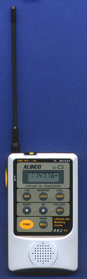

| DJ-C5T
      SPECIFICATIONS Revolutionary Credit Card Sized VHF/UHF DUAL-BAND Micro Transceiver  | ||
    GENERAL | |
| Frequency Coverage: | VHF TX: 144 ~ 147.995MHz RX: 118 ~ 173.995MHz UHF TX: 420 ~ 449.995MHz RX: 420 ~ 449.995MHz  | |
| Signal Type: | NFM, F3E | |
| Receiver System: | Double Conversion Super-heterodyne | |
| Channel Step: | 5KHz, 10KHz, 12.5KHz, 15KHz, 20KHz, 25KHz, 30KHz, 50KHz | |
| Memory Channels: | 50 memory channels | |
| Tone Encoder: | 39 tone encoder standard | |
| Tone Decoder: | 26 tone decoder standard | |
| Offset range: | 0 ~ 99.995MHz | |
| Deviation: | +/- 5KHz | |
| TX Output: | 300mW | |
| TX Spurious emissions: | Not more than -60dB | |
| Frequency Stability: | + or - 5ppm (-10 ~ + 50 degrees C.) | |
| Sensitivity: | Better than -15dBu (12dB SINAD) | |
| Selectivity: | -6dB/+ or - 12KHz | |
| I.F.: | (1st) 21.7MHz / (2nd) 450KHz | |
| Power Supply Requirements: | Internal 3.7vDC Lithium-ion battery (rechargeable) | |
| Current Consumption: | TX: 240mA [VHF], 300mA [UHF] RX (squelched): 30mA [VHF], 40mA [UHF]  | |
| Operating Temperature: | -10 ~ +60 degrees C, 14 ~ 140 degrees F | |
| Dimensions: | 56(W) x 94(H) x 13.6(D)mm (without projections) | |
| Weight: | approx. 85g | |
Specifications subject to change without notice or obligation
| Features:
       50 memory channels CTCSS tone encoder / decoder standard Volume/Squelch control Keylock Auto power OFF with Morse Code alert Mic/Earphone jack TX lamp Pivoted membrane keys Free offset Reverse monitor Scan function with skip setting Multiple European tone bursts Battery save mode Channel display mode AM aircraft receive with expanded VHF wide band reception  |
