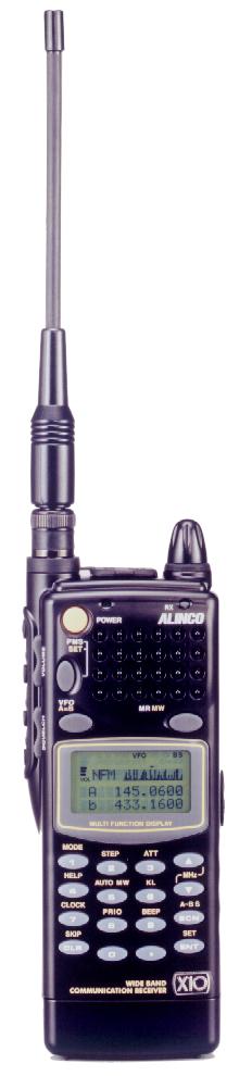

| DJ-X10T
      SPECIFICATIONS 100KHz ~ 2000MHz ALL-MODE Communications Receiver  | ||
    GENERAL | |
| Frequency Coverage: | 100KHz ~ 2000MHz (less cellular band on US version)  | |
| Mode: | WFM, NFM, AM, CW, USB, LSB  | |
| Reveiver System: | Triple Conversion Super-hterodyne  | |
| Channel Step: | 50Hz, 100Hz, 1KHz, 2KHz, 5KHz, 6.25KHz, 9KHz, 10KHz, 12.5KHz, 15KHz, 20KHz, 25KHz, 30KHz, 50KHz, 100KHz, 125KHz, 150KHz, 200KHz, 250KHz, 500KHz, or Auto Steps | |
| Memory Channels: | 1200 Channels (40 channels X 30 banks) | |
| Antenna Impedance: | 50 Ohms unbalanced | |
| Frequency Stability: | Better than 10ppm (-10 ~ + 50 degrees C.) | |
| Sensitivity: | 0.1 ~ 0.5MHz / AM: 10uV (20dBu) 0.5 ~ 5MHz / AM: 1.5uV (3.5dBu), SSB/CW: 0.5uV (-6dBu) 5 ~ 30MHz / AM: 1uV (0dBu), SSB/CW: 0.25uV (-12dBu), NFM: 0.35uV (-9dBu) 30 ~ 1000MHz / AM: 1uV (0dBu), SSB/CW: 0.5uV (-6dBu), NFM: 0.5uV (-6dBu), WFM: 1.5uV (3.5dBu) 1000 ~ 1300MHz / SSB/CW: 1.5uV (3.5dBu), NFM: 1.5uV (3.5dBu) 1300 ~ 2000MHz / SSB/CW: 10uV (20dBu), NFM: 10uV (20dBu) AM/SSB/CW: 10dB S/N. NFM/WFM: 12dB SINAD  | |
| Selectivity: | SSB/CW: -6dB/4KHz or better AM/NFM: -6dB 15KHz or better WFM: -6dB 150KHz or better  | |
| I.F.: | (1st) 736.25/275.45MHz (2nd) 45.05MHz (3rd) 455KHz/10.7MHz (WFM)  | |
| Power Supply Requirements: | 4.8 ~ 13.8v DC | |
| Current Consumption @ 13.8v DC: | At normal AF output: 200mA, squelched: 140mA, squelched with battery saver ON: 30mA | |
| Operating Temperature: | -10 ~ +60 degrees C, 14 ~ 140 degrees F< /TD> | |
| Dimensions (with EBP-37N without projections) : | 57(W) x 150(H) x 27.5(D) mm 2-1/4"(W) x 6"(H) x 1-1/16"(D) inches | |
| Weight: | approx. 320g | |
Specifications subject to change without notice or obligation
| Features:
       Large, Illuminated display User selectable or automatic mode and resolution settings User selectable English or Japanese operating system Dual VFO's 1200 EEPROM based non-volatile memories 40 segment "channel scope" spectrum display Selectable 20dB attinuator Internal clock Help message menu system Beginner/expert modes 3 line Alpha-numeric tag with text-edit Multiple s-meter display modes User selectable or automatic band plan Automatic memory write capability Multiple scanning modes Scans 25 channels a second Battery save function Auto power on/off capabilty Cable cloning function DC jack for external power source. Monitor key PC programable and controlable in real time Software will be available in most formats  |
