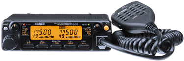

Tx: 144.000 - 147.995/430.000 - 449.994 MHz
Rx: 136.000 -
173.995/420.000 - 470.000 MHz
ADVANCED FEATURES
100 MEMORIES, STANDARD
Memory
channels to spare; 50 selections plus a CALL channel for each band. Store
odd-spilts, cross-band settings, repeater offsets, CTCSS tones, simplex and even
extended receive frequencies (like NOAA weather) in any of the memory channels.
(See specification chart for extended receive ranges.)
CROSS-BAND OPERATIONS
Transmit on one band and receive on the other. Operate cross-band in full
duplex (simultaneous transmit and receive). The DR-605T can also be used as a
temporary cross-band repeater for special events or emergency use.

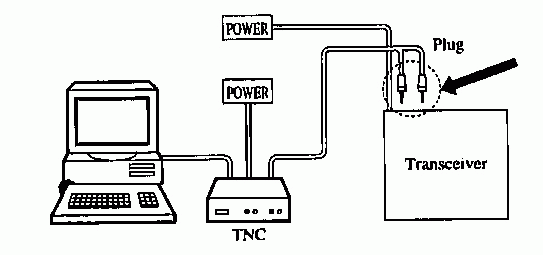

9600 OR 1200 BPS PACKET OPERATION
No modifications needed -
the DR-605T comes ready to work your favorite packet mod on either or both
bands. Dedicated 9600 bps packet connections are on the rear panel.
INTERNAL ANTENNA DUPLEXER
Connect your DR-605T directly to a dual-band antenna. You save by not
having to purchase a duplexer or an extra antenna (plus coax and connectors).
It's another way the DR-605T gets you on the air for less!
FREQUENCY + MEMORY CHANNEL DISPLAY
OR MEMORY CHANNEL
ONLY
Simplify operations with the
DR-605T's "Channel Only" display. Channel selection is easier for the new
operator and a time-saver during emergency operations.
SCANNING FUNCTIONS
Scan the
VFO or Memory Channels in ascending or descending order. Choose the scan "hold"
with "timed" or "busy frequency" hold. Adjustable "Time Out" Timer, essential
for packet and repeater operations. Choose the maximum amount of time the
DR-605T will transmit.
INDEPENDENT VHF/UHF TX-RX INDICATORS
No guesswork! Know at a glance which band is receiving a signal. Glows
green on receive and red when you transmit on either band.
"SET AND FORGET" SQUELCH CONTROL
No squelch knobs to accidently bump "open" or too high when adjusting
volume. Squelch for each band is set by you and stays at that setting
electronically, not mechanically, until you wish to adjust it.
CLONING CAPABILITY
Transfer
data from a programmed DR-605T to an unprogrammed unit by wire. ideal for
families or clubs, saves time and ensures uniformity.
CTCSS TONE SEARCH AND TONE SQUELCH
With the optional EJ-24U CTCSS tone decoder unit, the DR-605T will search
for and identify a CTCSS tone in a received signal. This option also allows
"tone squelch" operation. 50 CTCSS tone encode settings (transmit) included at
no extra cost.
MARS/CAP CAPABILITY
With the
proper permits, the DR-605T can be modified to enable use on MARS/CAP
frequencies.
