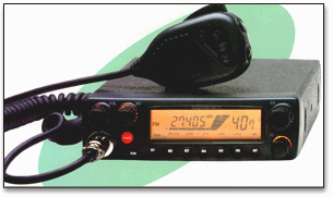

                          - Interesting SIX USER DEFINE
 FUNCTIONS on the
                          microphone.
                           - Powerful cover range with
 REPEATER FUNCTION.
                           - PROFESSIONAL DTMF SEL-CALL
 system as optional.
                          - FULLY SYNTHESIZED SYSTEM WITH MICRO PROCESSOR.
 - LARGE LCD FOR MULTI-FUNCTION DISPLAY.
 - FULL CHANNELS OR MEMORIZED CHANNELS ONLY SCANNING.
 - AUTOMATIC CONTROL OF LOW AUDIO LEVEL.
 - KEY LOCK SYSTEM.
 - MEMORY AND RECALL FUNCTIONS UPTO 7 CHANNELS.
 - INSTANT ACCESS TO CHANNEL 9 OR 19
 - DUAL CHANNEL WATCH.
 - REPEATER FUNCTION.
 - DIRECT DISPLAY OF SUPPLIED VOLTAGE.
 - BEEP ON OR OFF SELECTION.
 - SIX USER DEFINE FUNCTIONS ON THE MICROPHONE OUT OF
                          FUNCTIONS IN THE FRONT PANEL.
 - OPTION : - CHANNEL NUMBER EXPAND UPTO 400CHs
                          AM/FM.
 - TX OUTPUT POWER EXTEND UPTO 8WATT. -
                          DTMF SELECT CALL SYSTEM.
                | 1.
                  GENERAL |
                | CHANNEL |
                40CHs |
                | FREQUENCY |
                26.965MHz To
              27.405MHz |
                | FREQUENCY GENERATION |
                PLL SYNTHESIZER |
                | FREQUENCY STABILITY |
                +/- 0.001 % |
                | MODULATION |
                F3E/A3E |
                | IMPEDANCE |
                50§Ù |
                | POWER SOURCE |
                13.2V  |
                | OPERATING TEMPERATURE |
                -10¡É TO +60¡É |
                | DIMENSIONS |
                150(W) ¡¿
                  45(H) ¡¿ 157(D)mm  |
                | WEIGHT |
                990g |
                | 2.
                  RECEIVER SECTION |
                | CIRCUIT TYPE |
                DUAL CONVERSION SUPER
                  HETERODYNE |
                | IF FREQUENCY |
                1'st IF :
                  10.695MHz 2'nd IF : 455KHz |
                | SENSITIVITY |
                0.5uV IN FM FOR 20dB SND
                   0.7uV IN AM FOR 10dB S/N |
                | SELECTIVITY |
                60 dB min |
                | SPURIOUS REJECTION |
                60 dB min |
                | INTER MODULATION
                  DISTORTION |
                54 dB min ETSI
                MEASURED |
                | S/N RATIO |
                40 dB min |
                | AUDIO OUTPUT £À 10%
                THD |
                2 watt £À
              8§Ù |
                | 3.
                  TRANSMITTER SECTION |
                | POWER OUTPUT  |
                4.0 watt |
                | MODULATION |
                2KHz max, 80% TO
              95% |
                | DISTORTION |
                3% |
                | S/N RATIO |
                40dB max |
                | CURRENT DRAIN |
                1500 mA max |
                | SPURIOUS
                  ATTENUATION |
                ALL HARMONICS
                  & SPURIOUS ATTENUATION GREATER THAN ETSI REQUIREMENTS
