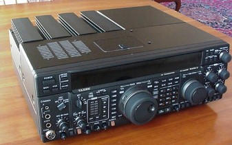

Introduced at the Dayton 2000 Hamvention, the new Yaesu Mark V/FT-1000MP transceiver is squarely aimed at the high performance contest and DX crowd. Combining the best of the venerable FT-1000D with the DSP and computer glitz of the mid-priced FT-1000MP, the Mark V is Yaesu's attempt to dominate the "elite class" market for the next decade. After swearing that I would never get rid of my beloved FT-1000D, I finally succumbed to temptation and shelled out $3269 for the basic Mark V and another $305 for two optional filters. There's still room for four more filters; however, to "load" the radio fully with filters would cost an additional $600! Here are some first impressions.

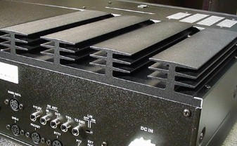

What first catches your eye about the new Mark V is the top heatsink, which is an integral part of the cabinet. Yaesu claims the heatsink has 250% greater cooling power than the rear-mounted heatsink on the FT-1000D. Like the FT-1000D, the Mark V runs 200 watts output. Whereas the FT-1000D used bipolar power transistors, the Mark V uses a pair of Phillips BLF147 power MOSFETS. A special "Class A" mode reduces power output to 75 watts, and is claimed to reduce IMD (distortion) to lower than -50db, which would best any ham transceiver ever made.

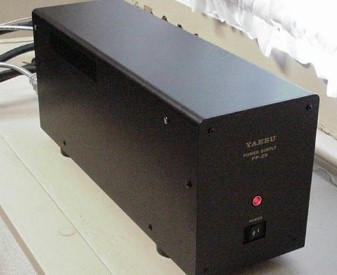

There's good news and bad news about the FP-29 external switching power supply The good news is that the FP-29, which provides 30V @15A and 13.8V@3A is included at no additional charge. The bad news is that the FP-29 has an irritating bottom-mounted fan (see below) which runs all the time. Though much quieter than the fan on Icom switchers, it's still audible in a quiet room. On the plus side, Yaesu provides a 2 meter long interconnecting cable, so the supply can be hidden behind the desk.

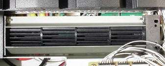

The unusual top-mounted heatsink (right) is cooled by a novel "paddle-wheel" internal fan (below). The fan is thermostatically controlled and doesn't run all the time.
Heatsink Fan
Mark V Heatsink

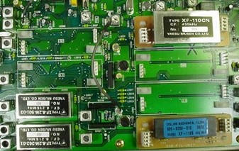

Plan on spending nearly $900 if you want to load up your Mark V with optional filters. The main receiver takes up to five optional filters for the 2nd and 3rd IF, and the sub-receiver holds one optional filter. The Mark V uses a combination of crystal and (Collins) mechanical filters. The three filters at the bottom of the photo are supplied (the blue one is a Collins 10 pole SSB filter --the FT1000MP uses an 8-pole filter.), while a 250 Hz optional filter is at the upper right. A nice new feature: the bandwidth of the DSP filtering is automatically interlocked to the bandwidth of the selected analog filters, even when using the "width" vernier.

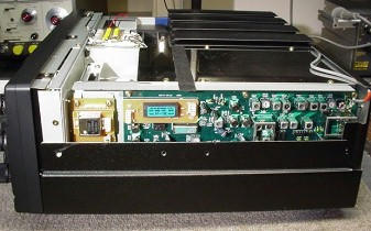

Out of the Box: My first challenge with the radio was installing two plug-in optional filters. I couldn't figure out how to take the cabinet off! The instructions in the manual were wrong (probably not updated from the FT-1000MP). In short, the cabinet is in four pieces, with 23 screws of three different types. Although it was easy to plug in the filters once I got the cabinet apart, it was then a challenge putting everything back together. Two tiny screws recess into the narrow space between the heatsink fins; nursing them back into their holes required a bright light and pair of curved tweezers. My advice: ask the dealer to install the filters for you. The blue Collins 500 Hz sub-receiver filter is shown in the below photo, to the right of the TCXO oscillator module.
Side View showing sub-receiver
Initializing the software for the selected filters was also confusing. More about this problem, below.

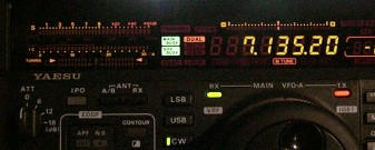

How about new features? Look closely at the right photo and you'll see "VRF" and "IDBT" on each side of the tuning knob, underneath the TX and RX LEDs. The VRF "Variable RF" button activates a manually-tuned front-end preselector, which one tweaks for maximum signal, just like us old-timers used to do on radios from previous eras. I guess the more things change, the more they stay the same.
Mark V Display
IDBT stands for "interlocked digital bandwidth tracking system," which sets the radio's DSP bandwidth to that used by the cascaded crystal and mechanical filters. What's neat about this feature is that it automatically corrects for adjustments in the IF shift and IF width controls. The feature can be toggled on or off by a button to the right of the tuning knob.

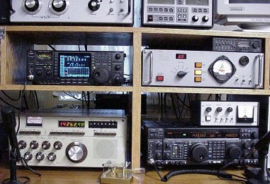

On-the-Air at Last! To get a feel for the new rig, I tried it side-by-side (see photo below) with an Icom IC-756PRO and a 15-year-old Signal/One Milspec 1030. First, let me dispell any notions you might have that radios were better in the "good old days." The top-of-the-line Signal/One just didn't cut it, receiver-wise. Compared to either the Yaesu or Icom, the Signal/One sounded noisier on the bands, the noise blanker didn't measure up to the others, the selectivity wasn't as good, and it sure wasn't as convenient to use. However, in the Signal/One's defense, people liked its rf-processed transmit audio better than the processed audio on the other rigs.
How does the Mark V stack up with IC-756PRO? Keep in mind that I wasn't pushing the radios to their limits, as one might do in a pileup on 160m CW or a multi-multi contest operation. These are impressions, not detailed technical comparisons.
So with that caveat, I'll first state the obvious. . . In terms of overall features the IC-756PRO wins out handily over the Mark V. With 6 meter coverage, lovely color display, bandscope, wide choice of filter bandwidths, and umpty-up menus, the Icom has nearly every bell and whistle imaginable. It also costs about a kilobuck less than a loaded Mark V. It's obviously a great value.
