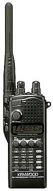

FM Handheld Transceiver TH-28(A/E)
Expanding the envelope of handheld communications is our multi-feature single-band handheld transceiver, the TH-28(A/E). State-of-the-art features include the ability to store both alphanumeric and frequency data in non-volotile memory, alphanumeric message paging -- in addition to DTSS and pager functions -- and a switchable dual-band receive capability. As an added bonus, the number of memory channels can be increased to 240 (option).
