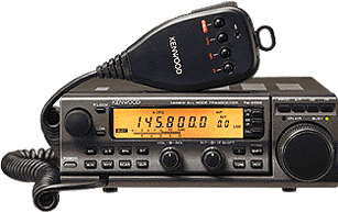

 All-mode versatility enters a new era with our innovative TM-255A/E (2 m)
and TM-455A/E (70 cm), both featuring a detachable front panel for easy
mounting in a car. But whether mobile or stationary, these compact transceivers
offer matchless performance -- in FM, SSB and CW modes. Among their many
impressive features are 101 memory channels, DDS with "fuzzy logic"
control, twin tuning dials, and a data connector for 1200/9600 bps packet
communications.
