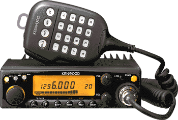

 Extremely compact and lightweight, Kenwood's TM-541A 1200
                MHz FM mobile transceiver is perfect for automobile installation
                and enhances night-time operation thanks to its illuminated
                keys, large LCD, and backlit mic with DTMF.
 Features at a glance:
10W RF power output |
Easy-to-read, easy-to-operate illuminated keys plus large LCD display |
Supplied multi-function backlit mic with DTMF  |
20 multi-function memory channels plus call channel  |
Built-in selectable CTCSS tone encoder (decoder option) |
ALT (Automatic Lock Tuning) function |
TM-541A in detail:
10W RF power output
Rugged and compact, the TM-541A has an RF output of 10 watts. It also
        features a HI/LO power switch that allows for power reduction to 1
        watt.
          display
The functionally designed control panel with individually backlit
        keys greatly enhances convenience and ease of operation during night-time
        use. Another welcome feature is the large, built-in multi-function
        LCD display which provides optimum visibility in direct sunlight or
        after dark. The display indicates frequency, frequency step, memory
        channel, tone frequency, lock-out memory channel, S & RF meter, BUSY,
        LOW, DTSS, T (Tone), REV (Reverse), CTCSS, and tone alert system.
        There are also dimmer controls which adjust LCD brightness in 4 steps
        to match ambient lighting conditions.
For enhanced operating ease in low-light situations, the supplied
        microphone is designed with large, backlit keys. Controls are provided
        on the microphone for CALL (call channel), VFO, MR (memory recall
        or change the memory channel) and a programmable function key. The
        programmable function key can be used to control one of the following
        functions on the radio: MHz, SHIFT, TONE, REV, DR/DT, LOW or MONITOR.
20 memory channels allow storage of frequency, TONE/CTCSS frequency,
        TONE ON/OFF status, and REV, for quick and easy access during mobile
        operation. Three channels (1-3) are used to store DTSS codes and ON/OFF
        status. Four channels (7, 8, 9 and 10) are used to store the transmit
        and receive frequencies independently for odd split repeaters.
Any one of the 38 sub-tone frequencies may be selected using the "Tone"
        key. The optional decoder enables all 37 EIA standard CTCSS frequencies,
        selectable via the main knob.
The automatic lock tuning function compensates for frequency drift.
Other Features:
Tone alert system with elapsed time indicator  |
DTSS (Dual Tone Squelch System) function  |
Pager function  |
Auto-power off function  |
Time-out timer  |
Lock function |
Multi-scan function  |
MHz switch  |
Programmable call channel function  |
Programmable VFO  |
Frequency step selection  |
Offset switch and repeater reverse switch  |
