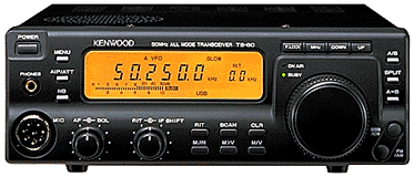

 The TS-60S is a 6 m all-mode transceiver that's engineered for excellence.
It's small enough for mobile or DX-pedition use, yet delivers an impressive
90W output. Ample power is matched by outstanding performance, thanks to
100 memory channels, AIP for superior dynamic range, and advanced
interference-reduction measures. There's also a friendly dual-menu system, microprocessor-controlled
DDS with "fuzzy logic" control, TF-SET, and everything you need
for split-frequency operations.

TS-60S in detail:
High power output
Despite its small size and light weight, the TS-60S is equipped with a pair
of MRF492 final transistors that enable it to deliver as much as 90 W in
SSB, CW and FM modes (23 W in AM mode).
