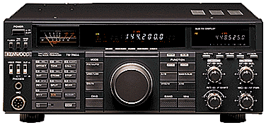

Demonstrating the full potential of an all-mode transceiver equipped with
advanced electronics, the powerful TS-790A/E sets the pace in terms of both
features and performance. As well as dual-channel watch and full-duplex
cross-band operation, it offers 59 multi-function memory channels. And when
equipped with the optional 23-cm band unit, it offers tri-band coverage
for maximum versatility. Feature for feature, there's no better way to explore
the expanding world of VHF and UHF communications.
