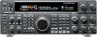

 Swift performance and surgical precision are second nature to the TS-950SDX. Quality engineering blends aesthetic simplicity of form with a wide range
of advanced features -- such as the built-in DSP (digital signal processor)
and MOS FET final section. The result is exceptional transmission signal
purity and first-class audio quality -- a benchmark for HF communications.
And operating ease is just as impressive, thanks to the convenient menu
system and many other user-friendly refinements.
